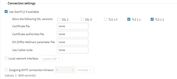

Current TLS settings,

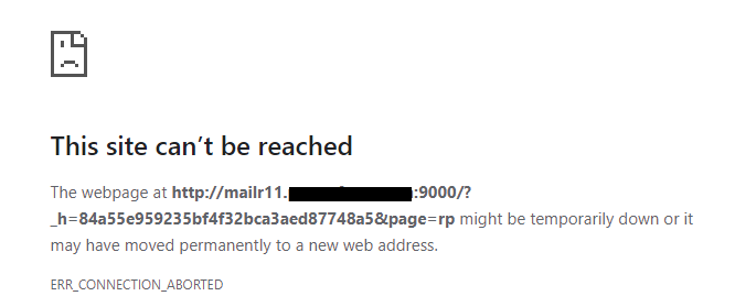

I was following below mentioned guide, but whenever I tried to add cipher and certificate file it gives me an error, the site can not be reached.

still same issue, when trying to add these values its givng me below mentioned error,

First of all you have to login into the WebAdmin interface.
If this action fails (even in an incognito browser tab or after you have restarted Axigen service) than we need to resolve this issue first.
If the WebAdmin interface is working and you could login than navigate to Security & Filtering > Acceptance & Routing > Routing basic settings > Outgoing delivery settings
In this section:
  • enable TLS1.0
  • use the following Cipher suite: ECDHE-RSA-AES128-SHA256:AES128-GCM-SHA256:RC4:HIGH:!MD5:!aNULL:!EDH
  • save configuration
Note: all of the above are mentioned in the Configure the outgoing TLS settings for compatibility section of the KB you have referred
same issue, page break
