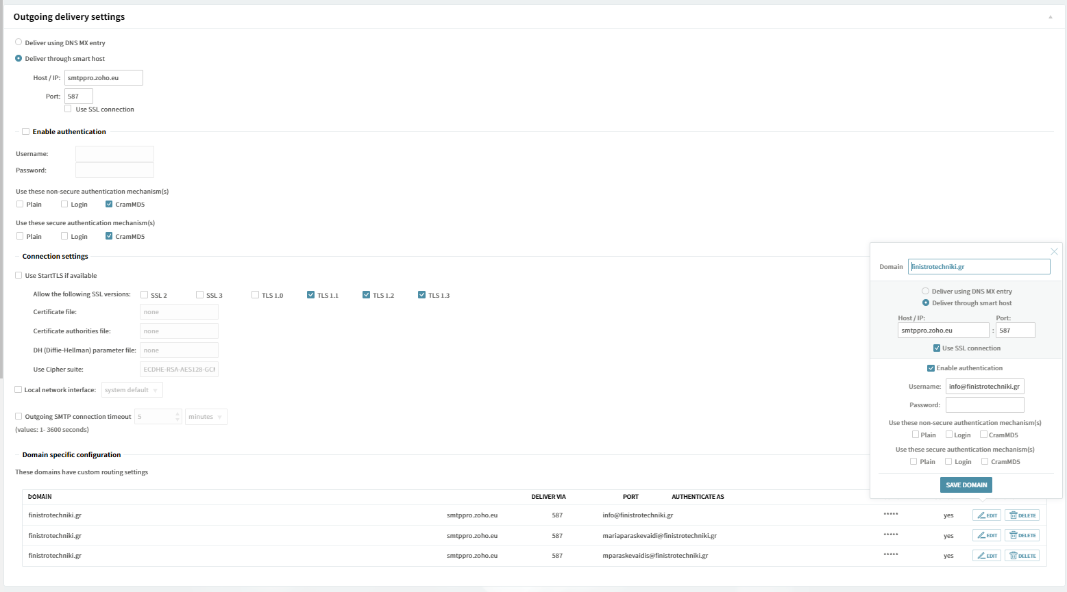

I am currently facing another issue,
It appears I cannot send emails from my axigen, neither I can configure my Zoho to handle the smtp outgoing messages.
here is the SMTP sending and everything LOG with full access control.
I also tried to configure domain specific for my 3 mailboxes the smtp relay it doesnt seem to work.
I use axigen’s self signe certs and the listereners are also added with secure ssl.
Could you please let us know what is the value for caBundlePath parameter from axigen.cfg?
