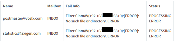

I saw this error today in the queue.
Not sure if that helps.
Thanks again in advance for your help.
MT1
From your post from 21 Nov we see that you have configured the AV:ClamAV filter to connect to 192.168.0.12:3310 but the error copied from the PROCESSING log shows that the filter is configured with 192.168.86.14:3310.
Have you restarted the Axigen docker after changing the address for this filter?
Could you try sending a test message (for example from WebMail, From “poastmaster” account To “postmaster” account) and post here the entire PROCESSING log lines (before this test please set PROCESSING log level to Communication Protocol in order to have more information saved into the logs).
