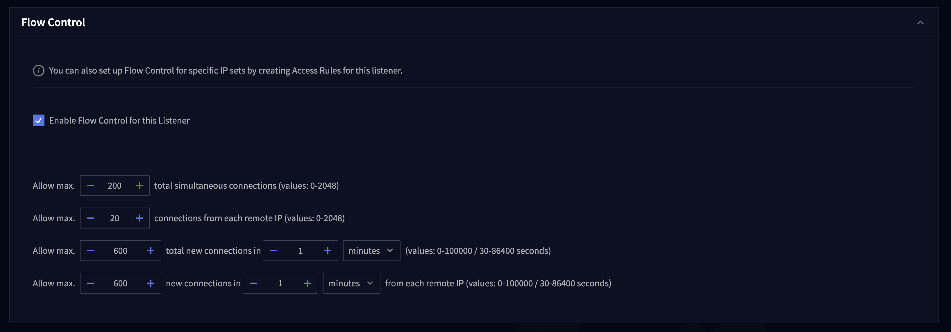

Hello @monachus!
The new connections are rejected due to the Flow Control configuration for Webmail listener on port 443 (HTTPS).
Tune these values based on your use case.
Be aware that service-level flow control is also active.
More information are available in the documentation at: Managing Service Listeners | Axigen Documentation

Hello @monachus
In your current setup, I think is better to disable the flow control in Axigen and enforce the corresponding limitations at the proxy layer.
Regarding netstat, it can be installed inside the container for troubleshooting purposes; however, this change will not persist after the container is recreated. You can install it using:
apt update && apt install -y net-tools
How do I disable it? Set the values to zero?

Helo @monachus,
You may disable the flow control at service level by changing the value to 0 or at listener level by unchecking “Enable Flow Control for this Listener” option.
