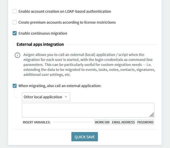

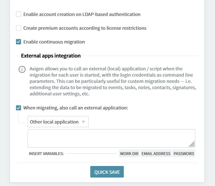

We’re new to Axigen and trying to setup a custom migration script but whenever we enter anything into the “Other local application” box and hit save it doesn’t retain it. Also there’s no documentation i could find that references what it expects here? I thought it would just be a path to the binary, but not sure. Is there a pre-requisite for this field to retain the information given it?
Yes, you should give the full path of the executable to be called.
Checking your report I think this is a WebAdmin bug so please confirm if, in fact, the migrationCommand from doman-migrationdata context is actually set as you make the change from WebAdmin.
