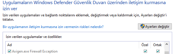

Router’s firewall is closed. May Windows Defender can block Axigen?

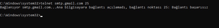

Try this: install telnet on the server of use putty to connect to remote email server on port 25.
for example in CMD type below command:
telnet smtp.gmail.com 25
you should receive this picture:
Connecting smtp.gmail.com…Didn’t connect with main, port 25: connection failed
So you have problem to connect to remote servers through port 25.
If you installed axigen on a host, maybe port 25 is blocked by them.
I have Axigen on my personal computer. Axigen exception is open.
I had to set up a forwarder from my ISP, due to them blocking port 25.
You might have to do the same. Search for your ISP name and Mail forwarder, and you might find something
