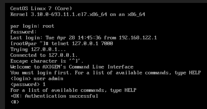

hi accessing to cli is very simple. But by default its accessible only on the server:
telnet 127.0.0.1 7000
user admin
[password]
