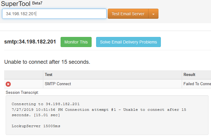

Regarding to your log file your domain name is “strouse.me” and MX record point to “mail.strouse.me” that port 25 is unreachable.

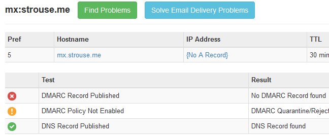

As you can see in the picture to solve your problem you need to determine the IP address of " mx.strouse.me" in a A record to your public DNS server. consider that for your email server you need to have a static IP not a dynamic IP.
I was able to fix my A record but I still do not receive the emails
now axigen is accessible.
