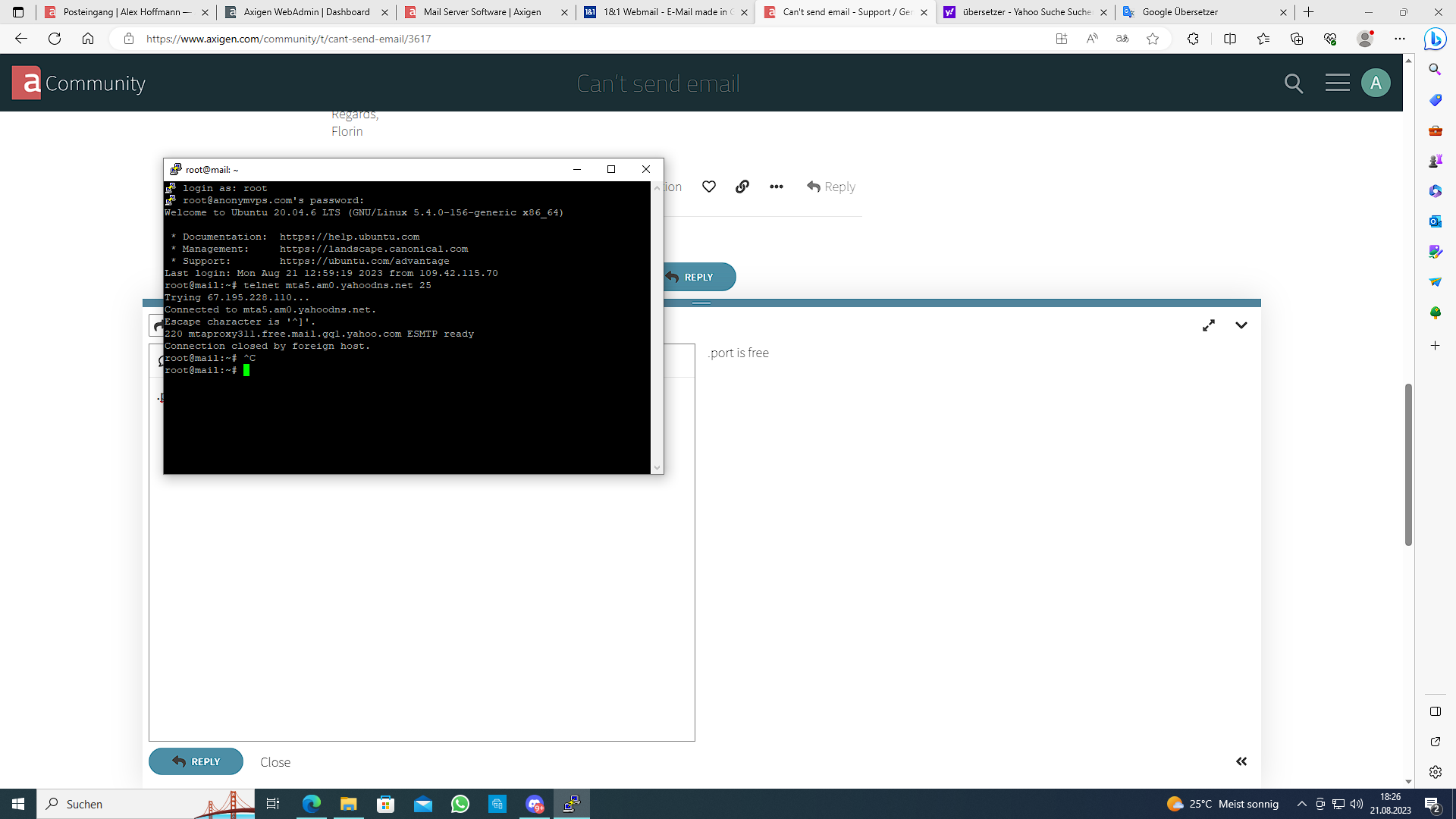

Hello unfortunately can’t send mail Mail comes in but no out does anyone have an idea
Hello @Aleyx
Can you provide us more details regarding your installation, like Axigen version, install type (classic or docker), the OS that host Axigen.
Also please check using telnet if your able to connect to a remote server on port 25, most ISPs are blocking this port by default.
sudo netstat -plnut

root@mail:~#
As I mentioned in PM the most probably the issue is you Internet Service Provider that block the egress traffic on port 25.
Please set SMTP Sending service log level to protocol communication and replicate an issue (by sending a message to en external email address).
If the message was not delivered (so it remains into the queue), please send us the SMTP-OUT logs so we could try to understand were is the problem (it may be a DNS issue as well).
