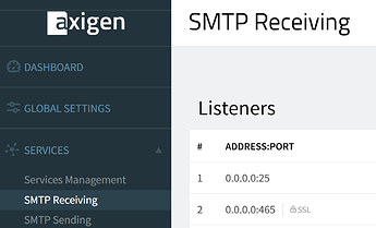

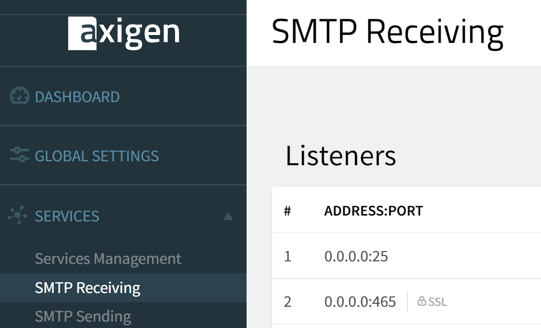

Could you check (from example from WebAdmin) if there is a listener on port 465 (configured with SSL) configured for SMTP Receiving service? Is it enabled?

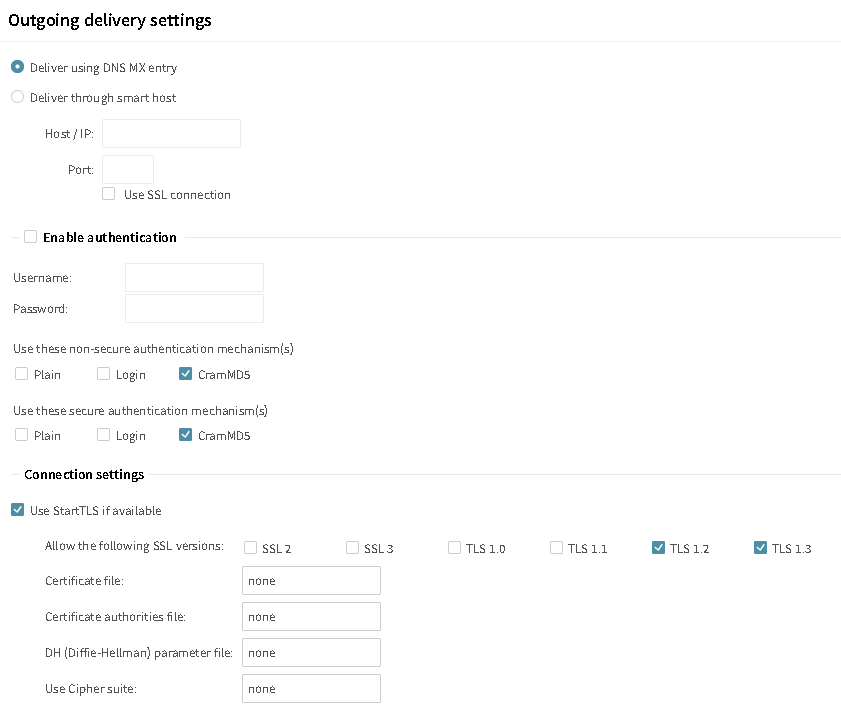

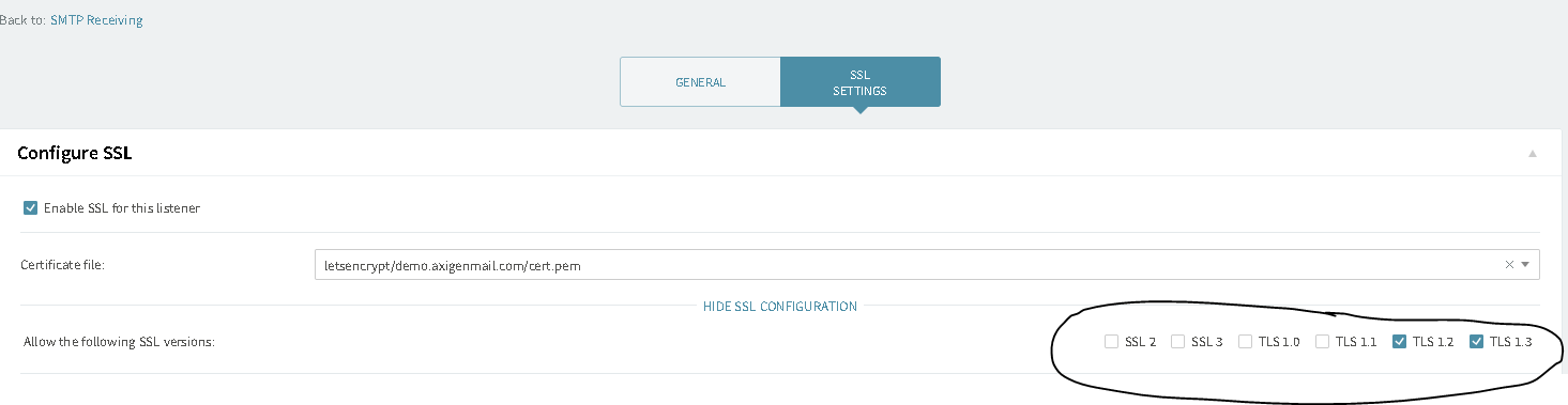

In this case you will allow / adjust the axigen to received multiple protocols.
And this setting to adjust your outgoing
