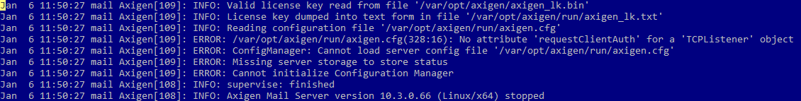

I could found im var/log/mail.log that the listeners could not start anymore and tried to change /var/opt/axigen/run/axigen.cfg by first changing the configuration of the listeners which relates to ssl connections (443,465,587,993,9443) and secondly by deleting this listener configurations (listeners regarding 25, 143, 7000, 9000 remains untouched) but /var/log/mail./log simply declares:
Jan 6 11:50:27 mail Axigen[109]: INFO: Valid license key read from file ‘/var/opt/axigen/axigen_lk.bin’
Jan 6 11:50:27 mail Axigen[109]: INFO: License key dumped into text form in file ‘/var/opt/axigen/run/axigen_lk.txt’
Jan 6 11:50:27 mail Axigen[109]: INFO: Reading configuration file ‘/var/opt/axigen/run/axigen.cfg’
Jan 6 11:50:27 mail Axigen[109]: ERROR: /var/opt/axigen/run/axigen.cfg(328:16): No attribute ‘requestClientAuth’ for a ‘TCPListener’ object
Jan 6 11:50:27 mail Axigen[109]: ERROR: ConfigManager: Cannot load server config file ‘/var/opt/axigen/run/axigen.cfg’
Jan 6 11:50:27 mail Axigen[109]:ERROR: Missing server storage to store status
Jan 6 11:50:27 mail Axigen[109]:ERROR: Cannot initialize Configuration Manager
Jan 6 11:50:27 mail Axigen[109]:INFO: supervise: finished
Jan 6 11:50:27 mail Axigen[109]:INFO: Axigen Mail Server version 10.3.0.66 (Linux/x64) stopped

Thank you for your response.
The issue is on IMAP configuration for listener on port 143 more exactly at line 328. To resolve this issue you will have to replace the line:
requestClientAuth = no
with
        sslControl = {
            allowedVersions = (tls1 tls1_1 tls1_2)
            certFile = "axigen_cert.pem"
            caFile = "none"
            dhParamFile = "axigen_dh.pem"
            maxChainDepth = 4
            cipherSuite = "ECDHE-RSA-AES128-GCM-SHA256:ECDHE-ECDSA-AES128-GCM-SHA256:ECDHE-RSA-AES256-GCM-SHA384:ECDHE-ECDSA-AES256-GCM-SHA384:DHE-RSA-AES128-GCM-SHA256:DHE-DSS-AES128-GCM-SHA256:kEDH+AESGCM:ECDHE-RSA-AES128-SHA256:ECDHE-ECDSA-AES128-SHA256:ECDHE-RSA-AES128-SHA:ECDHE-ECDSA-AES128-SHA:ECDHE-RSA-AES256-SHA384:ECDHE-ECDSA-AES256-SHA384:ECDHE-RSA-AES256-SHA:ECDHE-ECDSA-AES256-SHA:DHE-RSA-AES128-SHA256:DHE-RSA-AES128-SHA:DHE-DSS-AES128-SHA256:DHE-RSA-AES256-SHA256:DHE-DSS-AES256-SHA:DHE-RSA-AES256-SHA:!aNULL:!eNULL:!EXPORT:!DES:!RC4:!3DES:!MD5:!PSK"
            preferServerCipherSuiteOrder = yes
            useEphemeralKey = yes
Or you may use the repaired file axigen.txt (31.8 KB)

Dear Florin,
sorry for the late answer. Your assistance was very helpfull. I could start the system which runs now properly with all functions.
