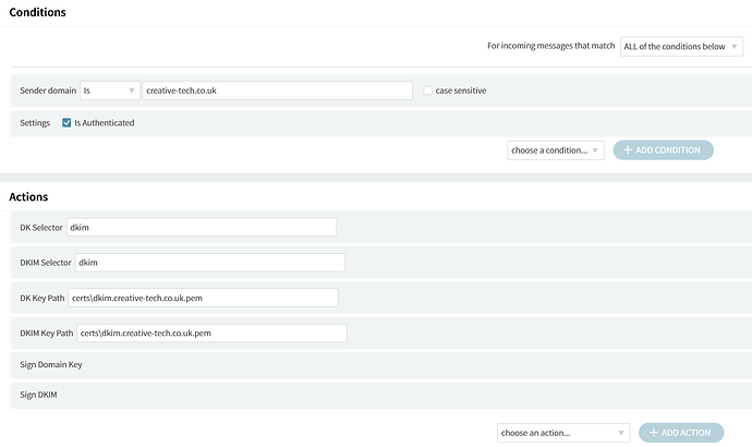

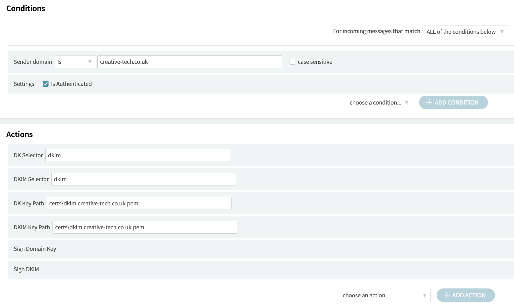

I think you’re looking at this the wrong way around. You use DKIM to sign ougoing emails from your domains.
Here’s what I’ve got configured for one of my test domains. All this does is look at the domain sending the email, then signs it with the appropriate certificate
