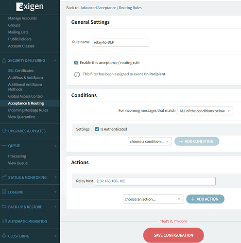

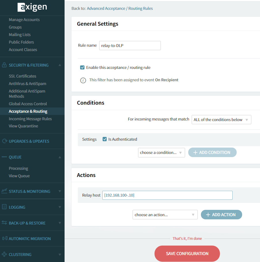

Assuming that your DLP service is running an SMTP service at 192.168.100.10 let’s configure the SMTP part:
WebAdmin > Security & Filtering > Acceptance & Routing > Advance Settings > Add new rule
  • name: relay-to-DLP
  • conditions: all of the below
    • Connection > Is authenticated > checked
  • action: Recipient > Recipient relay host = [192.168.100.10]
  • save configuration

2021-06-22 11:30:33 +0300 16 axigen SMTP-IN:00000014: >> 334 <TOKEN>=
2021-06-22 11:30:33 +0300 16 axigen SMTP-IN:00000014: << SASL client response
2021-06-22 11:30:33 +0300 16 axigen SMTP-IN:00000014: >> 334 <TOKEN>==
2021-06-22 11:30:33 +0300 16 axigen SMTP-IN:00000014: >> 235 Authentication successful
2021-06-22 11:30:33 +0300 08 axigen SMTP-IN:00000014: session from [<gateway>] authenticated by <user1@domain.tld>
2021-06-22 11:30:33 +0300 16 axigen SMTP-IN:00000014: << MAIL FROM: <user1@domain.tld>
2021-06-22 11:30:33 +0300 08 axigen SMTP-IN:00000014: Created new queue item with id 0002CF92
2021-06-22 11:30:33 +0300 08 axigen SMTP-IN:00000014: SPF result for MAIL FROM <user1@domain.tld@domain.tld> issued from EHLO domain <<Host_machine>> connected from <<gateway>>: Pass (spfHeader = ''; spfExplanation = 'SPF pass for authenticated connection')
2021-06-22 11:30:33 +0300 16 axigen SMTP-IN:00000014: >> 250 Sender accepted
2021-06-22 11:30:33 +0300 16 axigen SMTP-IN:00000014: << RCPT TO: <user2@domain.tld>
2021-06-22 11:30:33 +0300 08 axigen SMTP-IN:00000014: Set relay host name to <[192.168.100.10]:587>
2021-06-22 11:30:33 +0300 08 axigen SMTP-IN:00000014: Change relay host for <user2@domain.tld> to <[192.168.100.10]:587>
2021-06-22 11:30:33 +0300 08 axigen SMTP-IN:00000014: Use relay host <[192.168.100.10]:587> for delivering mail 0002CF92 to <user2@domain.tld>
2021-06-22 11:30:33 +0300 16 axigen SMTP-IN:00000014: >> 250 Recipient accepted
2021-06-22 11:30:33 +0300 16 axigen SMTP-IN:00000014: << DATA
2021-06-22 11:30:33 +0300 16 axigen SMTP-IN:00000014: >> 354 Ready to receive data; remember <CRLF>.<CRLF>
2021-06-22 11:30:33 +0300 16 axigen SMTP-IN:00000014: << 2261 bytes and final dot read
2021-06-22 11:30:33 +0300 08 axigen PROCESSING:0002CF92: Shepherd thread received signal for processing
2021-06-22 11:30:33 +0300 08 axigen PROCESSING:0002CF92: Set recipient <user2@domain.tld> state to RECEIVED
2021-06-22 11:30:33 +0300 08 axigen PROCESSING:0002CF92: Set mail state to PROCESSING
2021-06-22 11:30:33 +0300 08 axigen PROCESSING:0002CF92: Start processing mail
2021-06-22 11:30:33 +0300 08 axigen PROCESSING:0002CF92: Set recipient <user2@domain.tld> state to PROCESSING
2021-06-22 11:30:33 +0300 08 axigen PROCESSING:0002CF92: Start filter AV:Tnef of type socket filter from server
2021-06-22 11:30:33 +0300 08 axigen PROCESSING:0002CF92: Processing started
2021-06-22 11:30:33 +0300 08 axigen PROCESSING:0002CF92: Shepherd thread finished processing signal
2021-06-22 11:30:33 +0300 08 axigen PROCESSING:0002CF92: Filter AXI-TNEF(127.0.0.1:8888):[PASS]: pass - no changes
2021-06-22 11:30:33 +0300 08 axigen PROCESSING:0002CF92: Finished filtering mail object 02CF92 with filter: AV:Tnef of type socket filter from server
2021-06-22 11:30:33 +0300 08 axigen PROCESSING:0002CF92: Set recipient <user2@domain.tld> data version to 1
2021-06-22 11:30:33 +0300 08 axigen PROCESSING:0002CF92: Start filter dlp of type script filter from server
2021-06-22 11:30:33 +0300 08 axigen PROCESSING:0002CF92: Keep requested for <user2@domain.tld>
2021-06-22 11:30:33 +0300 08 axigen PROCESSING:0002CF92: Finished filtering mail object 02CF92 with filter: dlp of type script filter from server
2021-06-22 11:30:33 +0300 08 axigen PROCESSING:0002CF92: Start filter text appender
2021-06-22 11:30:33 +0300 08 axigen PROCESSING:0002CF92: Finished filtering mail object 02CF92 with filter: text appender
2021-06-22 11:30:33 +0300 08 axigen PROCESSING:0002CF92: Set recipient <user2@domain.tld> data version to 2
2021-06-22 11:30:33 +0300 08 axigen PROCESSING:0002CF92: Start filter onProcessing event
2021-06-22 11:30:33 +0300 08 axigen PROCESSING:0002CF92: Finished filtering mail object 02CF92 with filter: onProcessing event
2021-06-22 11:30:33 +0300 08 axigen PROCESSING:0002CF92: Set recipient <user2@domain.tld> state to PROCESSED - RELAY
2021-06-22 11:30:33 +0300 08 axigen PROCESSING:0002CF92: Set mail state to PROCESSED
2021-06-22 11:30:33 +0300 08 axigen PROCESSING:0002CF92: Processing finished
2021-06-22 11:30:33 +0300 08 axigen PROCESSING:0002CF92: Shepherd thread received signal for delivery
2021-06-22 11:30:33 +0300 08 axigen PROCESSING:0002CF92: Shepherd thread finished delivery signal
2021-06-22 11:30:33 +0300 08 axigen PROCESSING:0002CF92: Start mail delivery
2021-06-22 11:30:33 +0300 08 axigen PROCESSING:0002CF92: Set mail state to SENDING
2021-06-22 11:30:33 +0300 08 axigen PROCESSING:0002CF92: Start remote delivery for 1 recipients in domain [192.168.100.10]
2021-06-22 11:30:33 +0300 08 axigen PROCESSING:0002CF92: Automatic migration relay for mail 02CF92 to [192.168.100.10]:587
2021-06-22 11:30:33 +0300 08 axigen PROCESSING:0002CF92: Use plain connection
2021-06-22 11:30:33 +0300 08 axigen PROCESSING:0002CF92: STARTTLS extension allowed
2021-06-22 11:30:33 +0300 08 axigen PROCESSING:0002CF92: Allowed ssl versions set to: tls11 tls12 tls13
2021-06-22 11:30:33 +0300 08 axigen PROCESSING:0002CF92: Set AUTH user to <dlpadmin>
2021-06-22 11:30:33 +0300 08 axigen PROCESSING:0002CF92: Set AUTH password to *****
2021-06-22 11:30:33 +0300 08 axigen PROCESSING:0002CF92: Relay mail using default host: <[192.168.100.10]:587>
2021-06-22 11:30:33 +0300 08 axigen PROCESSING:0002CF92: Relay mail: add host 192.168.100.10 with priority 0
2021-06-22 11:30:33 +0300 08 axigen PROCESSING:0002CF92: Use 192.168.100.10 to relay mail 02CF92 for domain [192.168.100.10]
2021-06-22 11:30:33 +0300 08 axigen SMTP-OUT:00000003: Relay mail 02CF92: connecting to 192.168.100.10:587
2021-06-22 11:30:33 +0300 08 axigen SMTP-OUT:00000003: Relay mail 02CF92: connected to 192.168.100.10:587
2021-06-22 11:30:33 +0300 16 axigen SMTP-OUT:00000003: << 220 DLP-machine.domain.tld PVA/SMTP Ready.
2021-06-22 11:30:33 +0300 16 axigen SMTP-OUT:00000003: >> EHLO axigen.domain.tld
2021-06-22 11:30:33 +0300 16 axigen SMTP-OUT:00000003: << 250-Requested mail action okay, completed.
2021-06-22 11:30:33 +0300 16 axigen SMTP-OUT:00000003: << 250 AUTH LOGIN
2021-06-22 11:30:33 +0300 08 axigen SMTP-OUT:00000003: Start sending mail 02CF92
2021-06-22 11:30:33 +0300 16 axigen SMTP-OUT:00000003: >> MAIL FROM:<user1@domain.tld>
2021-06-22 11:30:33 +0300 16 axigen SMTP-OUT:00000003: << 530 Authentication required.
2021-06-22 11:30:33 +0300 08 axigen SMTP-OUT:00000003: Negative reply to MAIL command: Authentication required.
2021-06-22 11:30:33 +0300 08 axigen SMTP-OUT:00000003: Set recipient <user2@domain.tld> state to RELAY ERROR
2021-06-22 11:30:33 +0300 08 axigen SMTP-OUT:00000003: Delivery attempt completed for mail 02CF92; schedule for cleanup
2021-06-22 11:30:33 +0300 08 axigen SMTP-OUT:00000003: Set mail state to SENT
2021-06-22 11:30:33 +0300 16 axigen SMTP-OUT:00000003: >> QUIT
2021-06-22 11:30:33 +0300 08 axigen PROCESSING:0002CF92: Shepherd thread received signal for cleanup
2021-06-22 11:30:33 +0300 08 axigen PROCESSING:0002CF92: Mail removed from queue
2021-06-22 11:30:33 +0300 08 axigen PROCESSING:0002CF92: Set mail state to REMOVED
2021-06-22 11:30:33 +0300 04 axigen SMTP-IN:00000014: Reject mail <003801d76740$de0f46f0$9a2dd4d0$@domain.tld>: processing error (Authentication required.)
2021-06-22 11:30:33 +0300 16 axigen SMTP-IN:00000014: >> 552 Mail rejected by the processing module: Authentication required.
2021-06-22 11:30:33 +0300 16 axigen SMTP-OUT:00000003: << 221 Closing connection.
2021-06-22 11:30:33 +0300 08 axigen SMTP-OUT:00000003: Disconnected from 192.168.100.10
2021-06-22 11:30:33 +0300 08 axigen PROCESSING:0002CF92: Shepherd thread finished cleanup signal
2021-06-22 11:30:35 +0300 08 axigen JOBLOG:B000002D: user1+INBOX@domain.tld[headers]: Sort index update finished (1 inserts, 0 deletes, 0 updates, 27.137788 ms)
2021-06-22 11:30:36 +0300 08 axigen IMAP:00000016: [<Axigen-IP>:143] connection accepted from [<gateway>:60807]
2021-06-22 11:30:36 +0300 08 axigen IMAP:00000016: User [user1@domain.tld] successfully authorized!
2021-06-22 11:30:36 +0300 08 axigen JOBLOG:B0000041: user1+Sent@domain.tld[headers]: Sort index update finished (1 inserts, 0 deletes, 0 updates, 43.154857 ms)
2021-06-22 11:30:36 +0300 16 axigen SMTP-IN:00000014: << QUIT
2021-06-22 11:30:36 +0300 16 axigen SMTP-IN:00000014: >> 221-axigen.domain.tld Axigen ESMTP is closing connection
2021-06-22 11:30:36 +0300 16 axigen SMTP-IN:00000014: >> 221 Good bye
Vlad
Hello Vlad,
From the above log lines it is clear that Axigen is not sending the message to DLP using an authenticated session.
Could you please check sending a message via WebMail interface?
This is what I’ve used in my tests and I like to see if somehow it is different from receiving the original message via an authenticated SMTP session instead of the WebMail client.
Hello Vlad,
Disregard my previous message as I think I’ve found the culprit.
Please add 2 new actions into relay-DLP-auth SMTP advanced routing rule as follows:
  • Authentication > SSL connections > check all methods
  • Authentication > Plain connections > check all methods
It looks like your DLP service is not using StartTLS (thus you will have a plain connection) and only support LOGIN type auth.
Please let us know if with this workaround all is routed fine. If this is the case than some security tweaks could be checks (like enforcing StartTLS on DLP side).
Looking forward for your feedback.
Hello Ioan,
I managed to establish a functional connection between Axigen and the DLP service after some changes on Axigen and the deactivation of Authenticated Mail Submission on port 587 on the McAfee side.
The DLP service displays the incident that violated the policy and it also blocks that message by sending a mail to the sender with “552 Mail rejected by the processing module: : Mail rejected by the processing module: rejected by internal DLP policy”. Also, emails that do not violate the policy are allowed to pass and the X-RCIS-Action: ALLOW header is added.
I will also follow your last suggestions because a connection with a secure authentication is often preferable.
I keep you updated.
Vlad
Hello Ioan,
I can confirm to you that I have successfully made after your last suggestions, but with a few adjustments, a secure authentication and the transmission with the suite ECDHE-RSA-AES128-GCM-SHA256.
On this occasion I discovered several capabilities of the Axigen server which is very customizable!!
Thank you Ioan and good luck further!
