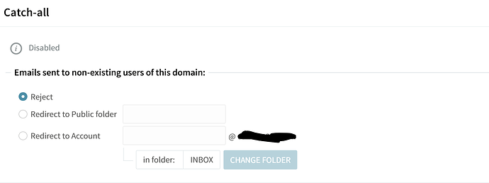

Hi Indreias,
this is our configuration :
Do you have a hint where else our configuration might be wrong ?
Thanks a lot !
Hello Stefano,
The catch-all configuration is set properly and I didn’t put the blame on it.
Please share full SMTP-IN log lines corresponding to a message that comes from an external server and have a single non existing recipient so we could trace why the message generates an NDR message from Axigen and not be rejected at session level (as expected).
