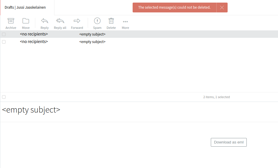

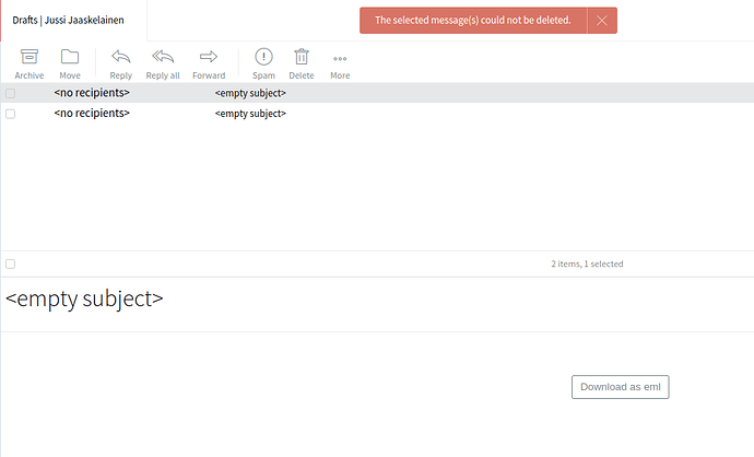

At the webmail, in Draft folder I have two empty messages what I cannot remove and what stays there even I reboot server.
Is there way to “fix” that folder and/or re-index, so those two empty messages will disappear?

According to the output the 2 messages from Draft folder are corrupted.
To remove them you may run again the findinvalidmsg command whit purge option:
<domain#> findinvalidmsg jussi.jaaskelainen purge

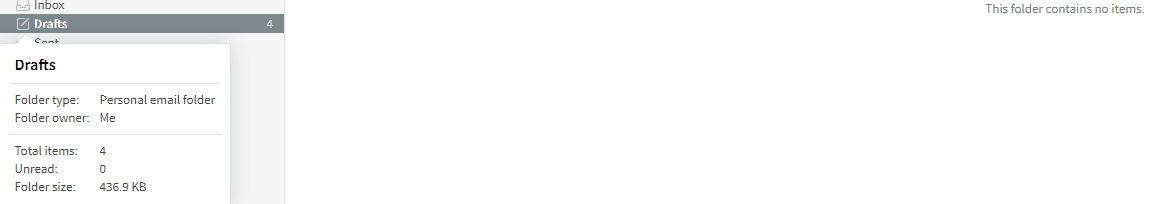

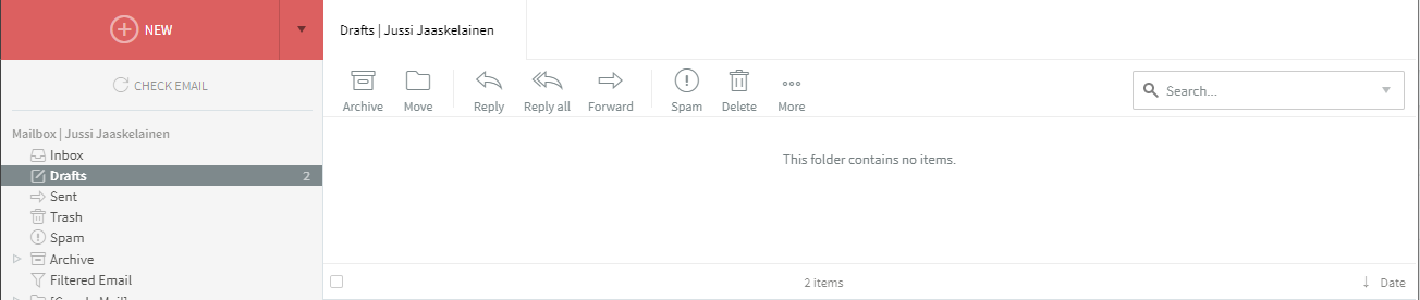

Again I have problem with Drafts and this time ‘findinvalidmsg’ command don’t fix the problem… Maybe because system don’t show any message subject lines.
And every time when I’m writing new message, the count of “Draft” folder is increasing…
How could I “recreate” that Draft folder?
