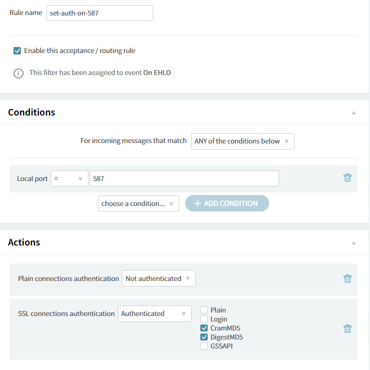

This could be done via an Advance Acceptance Rule (from WebAdmin > Security & Filtering > Acceptance & Routing > Advance Settings) like:
  • click on add new rule
  • provide a meaningful name for the rule
  • at condition put your specific one(s) - like: local port is 25
  • at actions set the desired authentication types via Authentication > SSL connection / Plain connection
For example I would disable at all all authentication types and enable, on 587, authentication only on secure connections like the capture from below:
