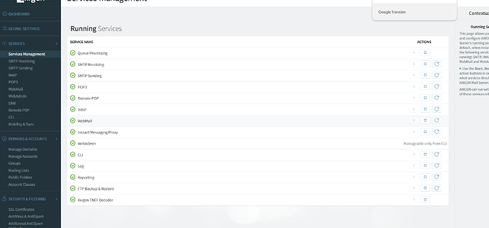

我按照流程进行了配置,配置了ssl证书,可以正常发送邮件,但是我不能收到任何邮件,所有服务显示正常
I have configured the SSL certificate according to the process and can send emails normally, but I cannot receive any emails. All services display as normal

How can I find the axigen.cfg file? I adjusted the log to protocol mode and resend the email, but there was no log increase. I followed the link above to reset SSL, but it did not take effect,
