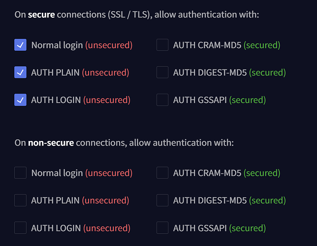

What we’re seeing in the everything.txt log is; “Cannot continue automigration for xxxxx: not plain authentication type”, and we’re a bit stumped on how to solve it :slight_smile:
I can post the full IMAP log if you like for that users session if that helps?

It works via Webmail exclusively, and i’m pretty sure it did work via the outlook client previously but after some additional configs for SSL it stopped working, could it be that its forcing an SSL connection but the remote end is expecting plaintext, and the Webmail client can handle that use case but the direct outlook client can’t ?
Yes, this is the expected behavior for accounts that are not already present on the Axigen side.
Only when the session is authenticated via an unsecured method, Axigen will have the opportunities to 1/ extract the password and 2/ to validate the password to the legacy email service from which the migration should be done.
Thus, we highly recommend to use only only SSL enforced listeners (for example only :993 for your IMAP service) and disable all secured methods, at least during the migration time.
