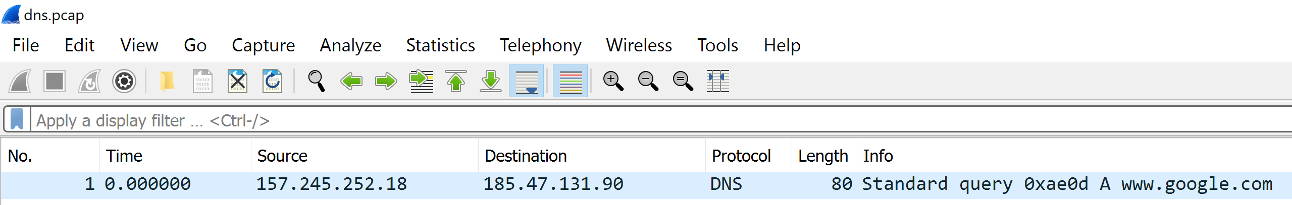

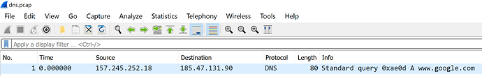

Let’s capture the traffic on both UDP and TCP port 53 when the renewal is executed so please start the following command:
$ tcpdump -i any -nn -s0 -w /var/tmp/dns.pcap port 53
and request a renewal for the LE certificate via WebAdmin (Security & Filtering > SSL Certificates > Renew button for the LE certificate).
After the failure is noticed into the Axigen log please stop the tcpdump session (with CTRL+C) and share with us:
i/ the Axigen log line saying “Couldn’t resolve host name …” (with the log timestamp)
ii/ the file generated by tcpdump (which is /var/tmp/dns.pcap)
Hello Ioan,
I have attached the dns.pcap file in this message
Thanks!
dns_pcap.rar (192 Bytes)
Hello David,
Well, from the tcpdump capture we see that your system is receiving DNS requests from Internet as there was captured only one record:
source: 157.245.252.18, port 50901 | belonging to Digital Ocean | AS14061
destination: 185.47.131.90, port 53 | this seems to be your system
DNS query: A www.google.com
As we do not see the expected DNS traffic to the configured DNS servers from /etc/resolv.conf (8.8.8.8 and 8.8.4.4) I could only suspect that you are using a more complicated setup.
As suggested, please double check what was changed on your system from the end of June (when the cert seems to be issued by LE) and today.
