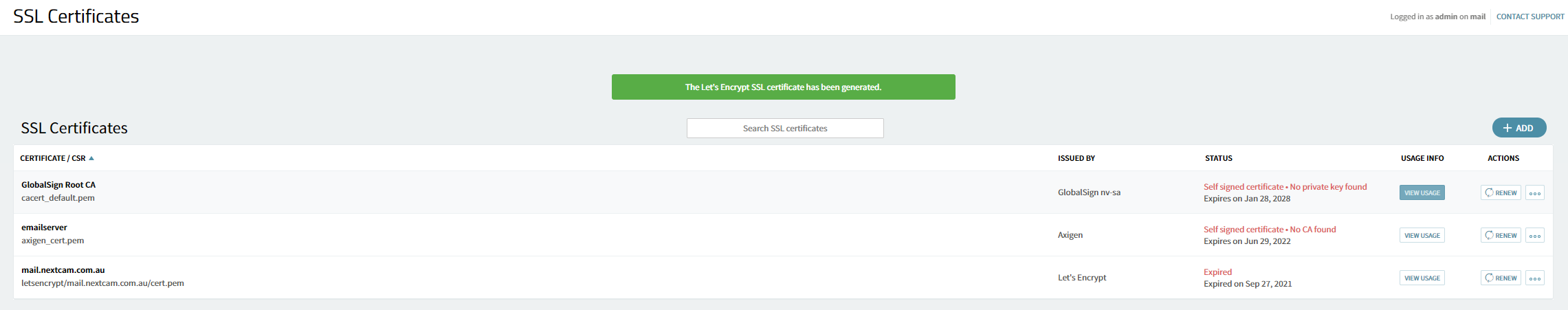

I used to have a Let’s Encrypt certificate in use. It expired a few days back so I clicked on the “renew” button to renew it. The popup notification on top saying it’s done successfully as shown in attached screenshot. However, the expiration date was never changed, that is, nothing happenning and it’s actually not renewed. I have tried this quite a few times in different time. Can anyone help?
Besides, when I clicked on the “Revoke” button, it would fail and replicate the same expired certificate and show up in the list.
