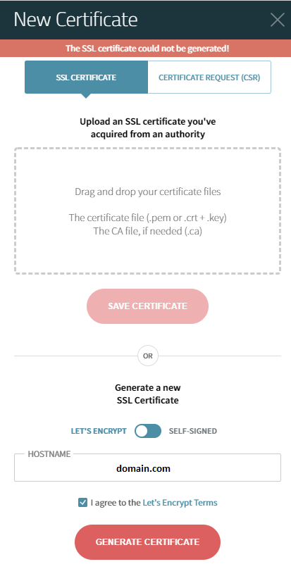

Since I’m still very new to Axigen, I’m not sure how to properly configure it to “Generate a new SSL from Let’s Encrypt”. I’ve been using them for quite a while and know how to create one manually, but if I can configure Axigen to autorenew it, that would be great! I’ve read through https://www.axigen.com/documentation/managing-ssl-certificates-p21594182 and https://www.axigen.com/documentation/lets-encrypt-support-p10649619, but don’t see the exact steps that will let me set it up correctly. Last time, I was able to manually add my Let’s Encrypt cert, but I’d like to take advantage of the advertised capability if I can.
When I tried via the GUI, it keeps giving me an error “The SSL certificate could not be generated!” (I’ve tried both domain.com as well as webmail.domain.com (both of which can be resolved by a DNS query) for the hostname and get the same results.)
Is there a document that I’m missing that can walk me through the steps? I also looked at the logs and found:

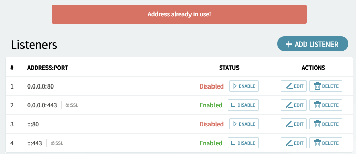

Well, I think you’re on the right track. redirection was turned on, but I’ve now turned it off. But I also see that in my WebMail, both of the Port 80 listeners are disabled and when try to enable it, I get an “Address already in use!” message. And when I try to open up webmail over port 80, it is still redirecting to 443.
And when I use the netstat command, I see:
TCP 0.0.0.0:80 0.0.0.0:0 LISTENING
Can not obtain ownership information
So it does look like there is something listening on port 80, but not Axigen. I’ve turned off my IIS and even restarted Axigen, but it keeps throwing the same error.

What’s interesting is that it appears that Let’s Encrypt can’t get to my server. When I go to my Axigen WebMail (Admin), it says that port 80 is disabled, but when I try to enable it, it shows a message saying, “Address already in use!” I know for a fact that my ports are forwarded to my server, but when I use a port checker, it’s showing as blocked. I think that Axigen has port 80 disabled somehow. When I do a NetStat -ab, it shows “Can not obtain ownership information” for port 80, but correctly shows axigen.exe for the other ports (25, 443, etc.) When I pull the PID for port 80, it shows as System.
I know this should be easy, so what am I doing wrong? Has anyone been able to get this to work on a Windows box directly from WebAdmin?

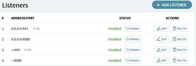

I finally figured it out and wanted to pass along just in case others had the same issue.
As I mentioned before, although Windows showed that there was a listener going on port 80, I couldn’t get a cert. (Let’s Encrypt it needs to validate the domain.) What I learned was that Axigen was not the listener and could not be enabled: Since Axigen was not the listener on port 80, it could not obtain the certificate from Let’s Encrypt via Axigen.
So what I decided to do was bind the non-SSL Listener to port 8080 and it enabled without a problem. I then forwarded port 80 to 8080 on my router.
Once I did that, I was able to have Axigen generate a new SSL certificate, which I then bound to the different listeners.

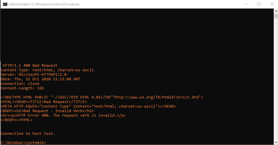

This is interesting - could you recheck and see if port 80 is still owned by System?
If yes, what do you obtain when you try to run the following command:
telnet localhost 80
and press several times ENTER key.
Yep, still owned by System, but when I do the telnet to port 80 as you asked, something does answer and I get a blank screen. I hit the ENTER key several times and finally the CRTL+C and get:
When telneting from a remote computer on the local network, I just get the standard “Connecting To server…Could not open connection to the host, on port 80: Connect failed” message like there isn’t a listener.
Well, it seems you have the answer: the owner of port 80 is Microsoft-HTTPAPI which seems to be related to WAMP ( a Windows web development environment).
I’ll let you the “pleasure” to hunt and identify the real culprit.
