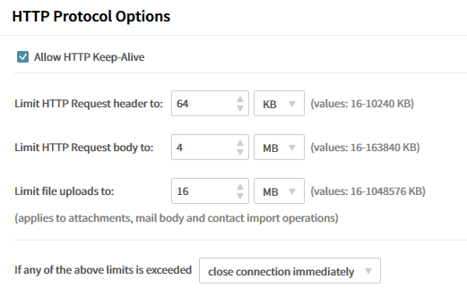

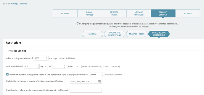

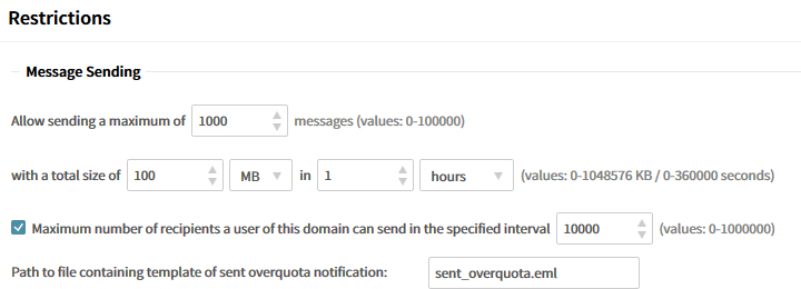

You also need to check 2 other locations:
SERVICES -> WEBMAIL -> HTTP Protocol Options
DOMAIN & ACCOUNTS -> Manage Domains -> [edit domain] -> ACCOUNT DEFAULTS -> SEND/RECEIVE RESTRICTIONS -> RESTRICTIONS
Please note that user configurations override domain configurations. If your problem does not solved check user limits.

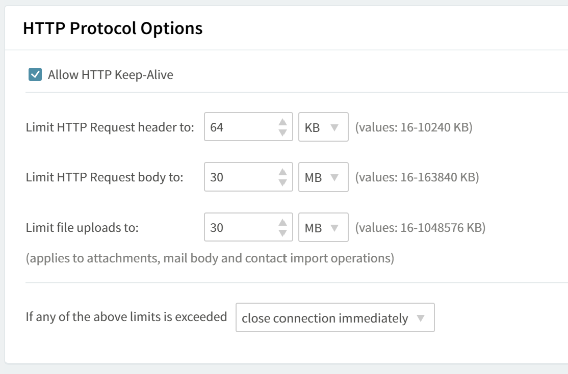

I cant see an issue with my configuration here either?
Tried:
  • Removing limits
  • setting mail body size from 4MB to 30MB

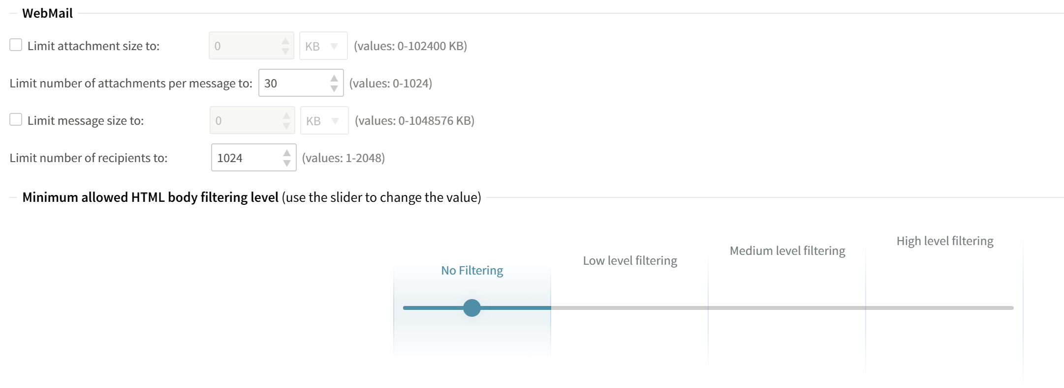

When I change the Limits on:
Configure Domain -> Account Defaults -> Quotas and Restrictions -> Webmail
then save the configuration, a new axigen.cfg file is created, but when I compare the previous .cfg file with the new .cfg file, there are no differences between the 2 files

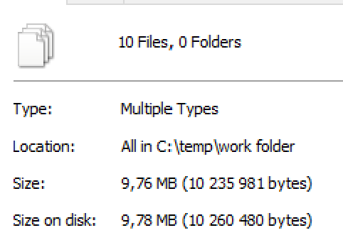

How much is the size of your attachments?
Please note that the attachment are coded in base 64 and then the size will grow with 30%,
for example in order to sent a message with 100MB files in attachment you need to set the limits up to 130MB.
The size is rougly 9,8MB

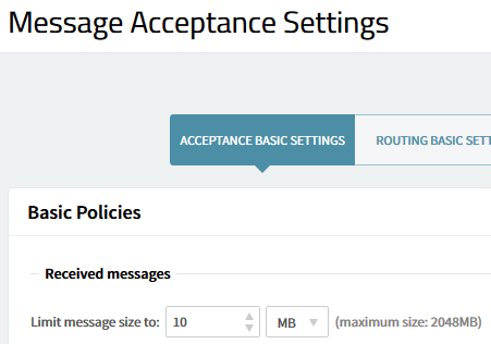

There is one other place that you need to check:
SECURITY & FILTERING - > Acceptance & Routing → Acceptance Basic Settings → Limit message size to
Setting the message size limit from 10MB to 30MB there fixed it.
Strange that it describes it as Received messages though, the recipient was an external address.
Thank you!!!
