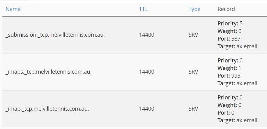

Thanks, Ioan, I’ve made those changes.
They have propagated.

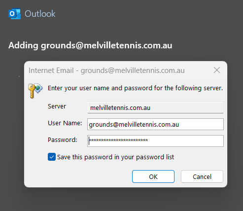

However, Outlook still thinks the mail server is melvilletennis.com.au
Synergy Wholesale support says the autodiscover record is correct, and they’re unsure why Outlook is not connecting to the right server.
Screenshot 2023-07-13 202655
