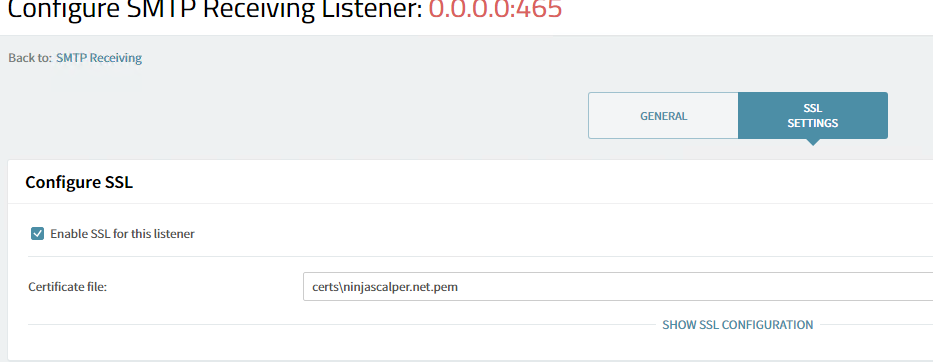

I have a problem with the SSL configuration.

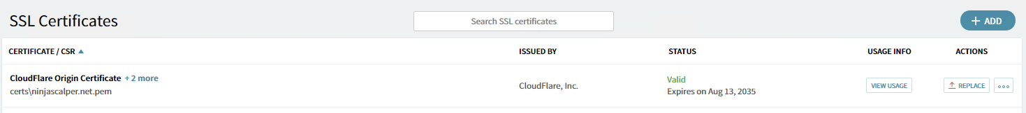

My certificate is already installed and valid. It is the same that is installed on my server for my website, so I can guarantee that it is working correctly:
I chose the certificate on port 465:
But at the time of doing an email sending test I am not getting it.
The following logs appear:

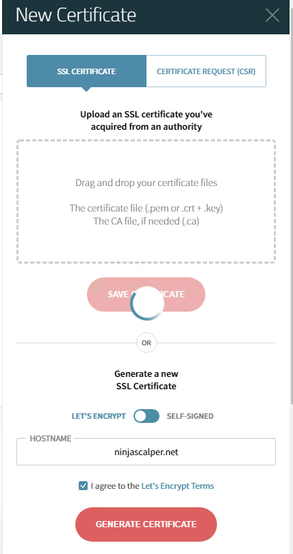

I tried to do the creation via LetsEncrypt, but it stays on this screen loading forever.
Logs:
2020-08-22 03:17:09 +0200 08 vps159681 WEBADMIN:00009C66: Let’s Encrypt: Issuance Job added successfully
2020-08-22 03:17:09 +0200 08 vps159681 WEBADMIN:00009C66: LetsE: Found current request
2020-08-22 03:17:10 +0200 08 vps159681 JOBLOG:70000031: LetsE: Acme job executing
2020-08-22 03:17:10 +0200 08 vps159681 JOBLOG:70000031: LetsE: Found current request
2020-08-22 03:17:10 +0200 08 vps159681 JOBLOG:70000031: LetsE: AcmeInitState for ninjascalper.net executing
2020-08-22 03:17:10 +0200 08 vps159681 WEBADMIN:00009C66: LetsE: Found current request
2020-08-22 03:17:10 +0200 02 vps159681 JOBLOG:70000031: HTTP-Client: Error performing request in connection to https://acme-v02.api.letsencrypt.org:443/directory:SSL peer certificate or SSH remote key was not OK
2020-08-22 03:17:10 +0200 02 vps159681 JOBLOG:70000031: LetsE: connection error on GET when populating acme link directory
2020-08-22 03:17:10 +0200 02 vps159681 JOBLOG:70000031: LetsE: Job step action => Connection-related error, re-attempting after 15 seconds
