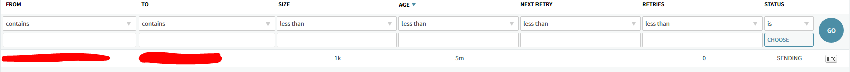

And this is what shows in queue. (sometimes stays stuck there for about an hour!)

The error you’re showing points to an SPF issue, but since you’re also having issues sending, could it be a DNS issue? Do you have a DNS set in Axigen? (I’d also be interested in the SMTP Send log.)
To find exact root cause of the delay I would recommend to set the log level for SMTP Receiving, SMTP Sending and Processing services to Protocol Communication and after that check in the resulting log files at which step the delay occurs.
If is possible please share the resulting log files.
