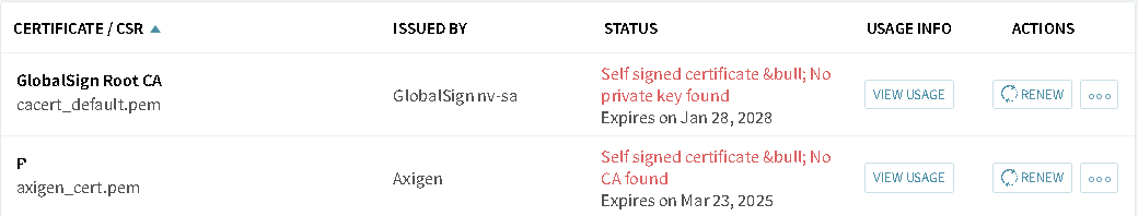

EDIT: By the way, the certificate with the “No CA found” status is called axigen_cert.pem and is located in the working directory

Just wanted to show what the WebAdmin tells me about the certificates:
It would be nice if somebody would tell me what to do to get Remote POP working - either with fixing the certificate or with disabling certificates (in Windows).
Thanks in advance.
Hello Wolfgang,
Do not worry about the Axigen certificates as them are for the server side (like SMTP / IMAP / POP3 and WebMail listeners) and RPOP is a client that connect to remote servers and fetch locally the remote messages.

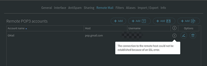

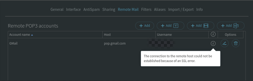

I am facing the same error: “The connection to the remote host could not be established because of an SSL error”
The log file keeps showing for the affected accounts the following in each connection retry:
2025-05-14 14:46:40 +0300 08 “HOSTNAME” RPOP:000000EB: rpop connection for account “xxxxxxxx@yyyyyyy.gr” rescheduled in 1 minutes
2025-05-14 14:46:41 +0300 02 “HOSTNAME” RPOP:00000000: SSL error remote 185.230.214.213:995, SSL_connect:failed in SSLv3/TLS write client hello
2025-05-14 14:46:41 +0300 02 “HOSTNAME” RPOP:00000000: 185.230.214.213:995 SSL_connect error
2025-05-14 14:46:41 +0300 02 “HOSTNAME” RPOP:000000EC: rpop connection for account “xxxxxxxx@yyyyyyy.gr” ended, status: 8;Cannot connect to remote host: SSL error

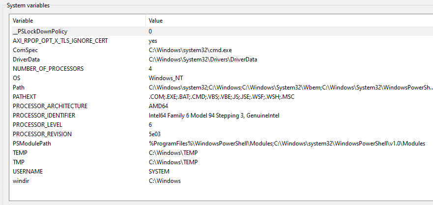

I have included the “AXI_RPOP_OPT_X_TLS_IGNORE_CERT=yes” in the System Environment Variables but not in

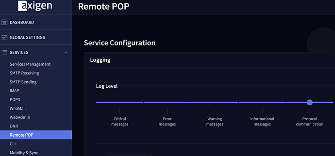

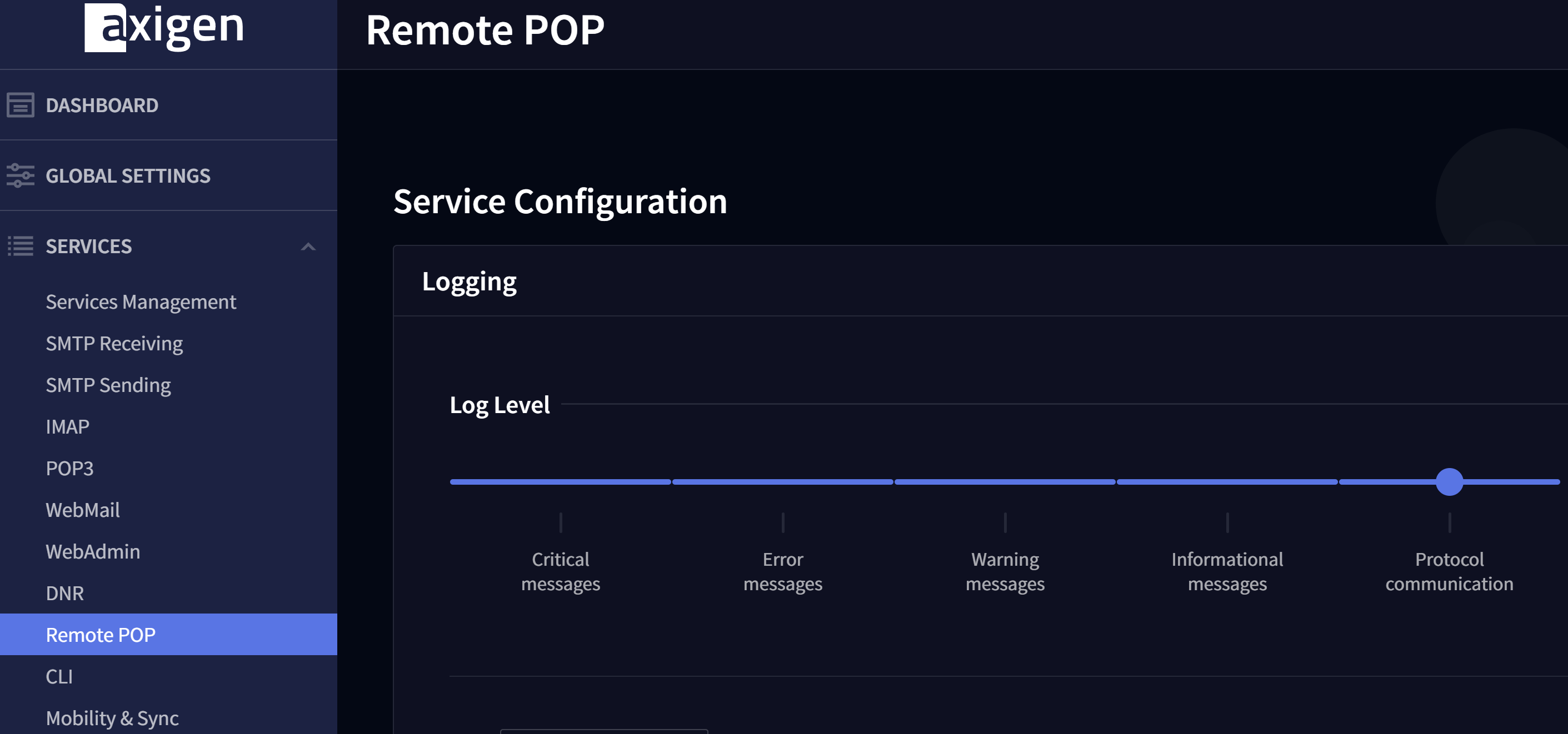

Could you please share a screen capture showing the Environment Variables > System variables from your Windows version?
Also, it will be best if you could re-share the RPOP logs after you have enabled Log Level to Protocol Communication for Remote POP service like below:
Hello Ioan
The log level was indeed in protocol communication setting in Log Server Settings but not in Services Management. I have set it as instructed and attach a part of the log that has the repeated errors for all accounts
RemotePOP.txt (306.1 KB)
