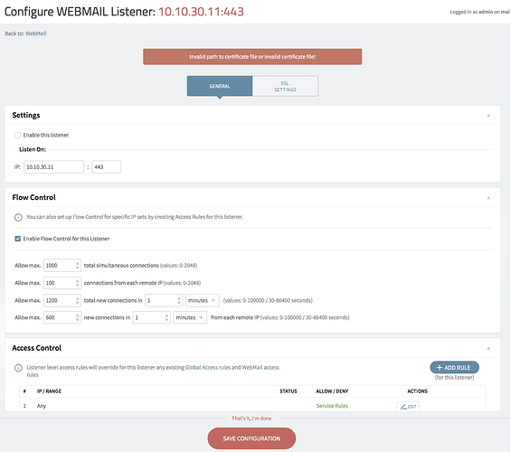

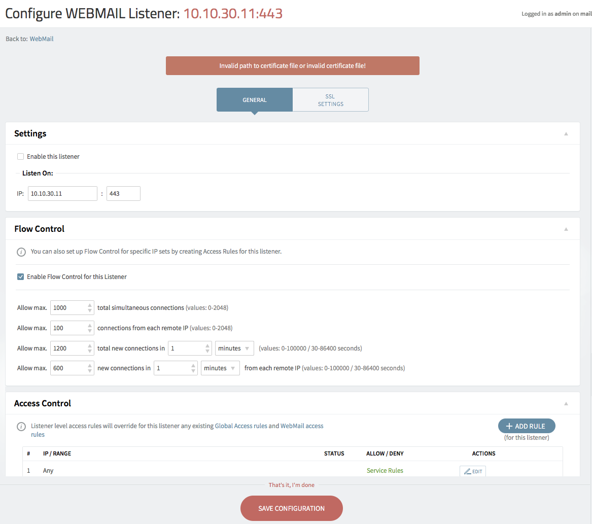

Hello Ioan,
thanks for the help. Still can’t do that, and I have no clue what I’m doing wrong.
I can only post one image, which is the screenshot of the error message. Permissions are 777 for axigen:axigen for both the certificate.pem and the intermediates.pem.
The uploaded .pem files were made from the .crt and .key files with a simple ‘cat’ command.
Where is the mistake?
Kind regards,
Peter

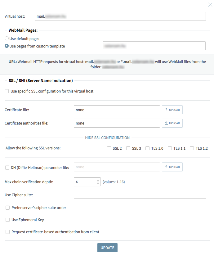

Hello Peter,
OK - no problems.
1/ Please double check if you have any virtual hosts that have enabled Use specific SSL configuration for this virtual host (WebAdmin > Services > WebMail > Virtual Hosts > Edit > SSL / SNI section).
If yes, please double check the files that are specified there as them are also verified when you are enabling the SSL WebMail listener
2/ Please provide more screen captures (for example you did not share the SSL settings for the listener you are trying to enable).
In other words help me to help you.
Hello Ioan,
thanks for your message. Please find the Virtual Hosts settings posted.
I believe the server is using the default Axigen cert for SMTP transactions. Can it be a problem, that for the Webmail I try to use our custom company cert? Do I need to use the same cert in both places?
Kind regards,
Peter

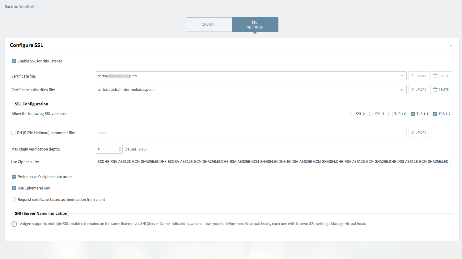

Hello Peter,
1/ So there are no virtual hosts in WebMail service that have SSL/SNI enabled - this is fine, so no possible errors here.

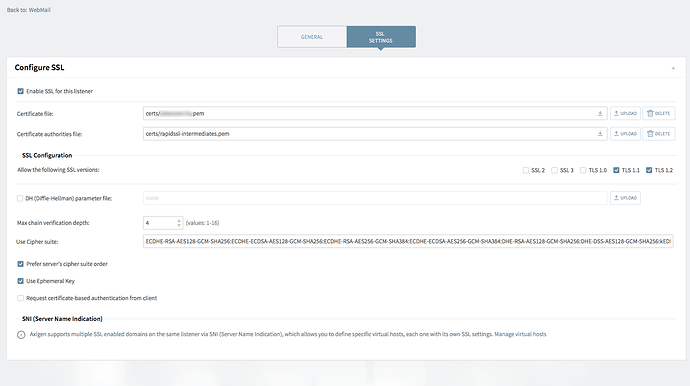

2/ Coming back to the WebMail listener on port 443 for which you could not enable SSL please share the SSL Settings of this listener as well.
3/ Regarding using different certificates for SMTP and WebMail there are no problems at all. More, you could use anytime different certificates on different listeners of the same service as well.
Hello Ioan,
please see the SSL settings posted. Both certificates have permissions like axigen:axigen 777.
Kind regards,
Peter

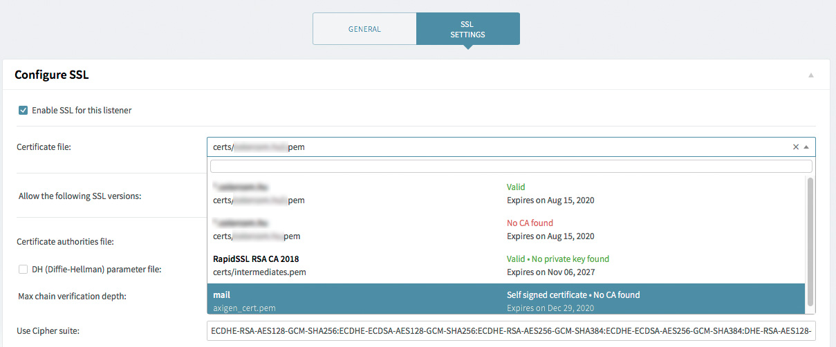

Just a follow-up for those who are not that strong on the SSL side, like me. In the latest Axigen incarnation (13) there is a nice feature which shows whether someone assembled the .pem file correctly or not.
If you copy all your assets into a pem file (any decent word processor or code writer app will do) it must be like this:
-----BEGIN RSA PRIVATE KEY-----
(Private Key: domain_name.key contents)
-----END RSA PRIVATE KEY-----
-----BEGIN CERTIFICATE-----
(Primary SSL certificate: domain_name.crt contents)
-----END CERTIFICATE-----
(Intermediate certificate: certChainCA.crt contents)
Now copy that to your designated certificates storage directory in the system, and chown it for axigen. If everything is fine, you will see a green ‘Valid’ message when you check the cert in the pulldown menus.
