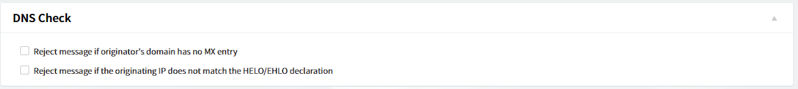

Could you please let us know your setup from: WebAadmin > Security & Filtering > Aditional Antispam Methods > DNS Check
PS: Why are you not just connecting to the WebMail interface, log in with the credentials for an existing account and send a test message from there?
Usually, accepting messages via an unauthenticated session is not a good ideea if some elements are not checked (one of them is to have a Fully Qualified Domain Name received into the EHLO command) - usually spammers are identifying themselves as DESKTOP-0193 or similar so it is a very simple method to filter spam just by enabling: Reject message if the originating IP does not match the HELO/EHLO declaration

The settings you asked, both are switched off
