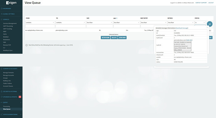

I will use Axigen as relay for my newsletter but i can’t send mail :
Fail-info : Unable to connect to 165.227.###.##: Connection timed out
Status :PROCESSED - RELAY
MBox :INBOX
I connect with 465 / SSL.
What can i do to repair ?

Hello Pierre,
When you see “connection timed out” messages it is an indication that the server could not connect to the remote party.
Have you tried to connect to that IP address on port 25 from the machine where you are running Axigen?
This could be done as simple as opening a command line terminal and run:
$ telnet <ip-address-here> 25
