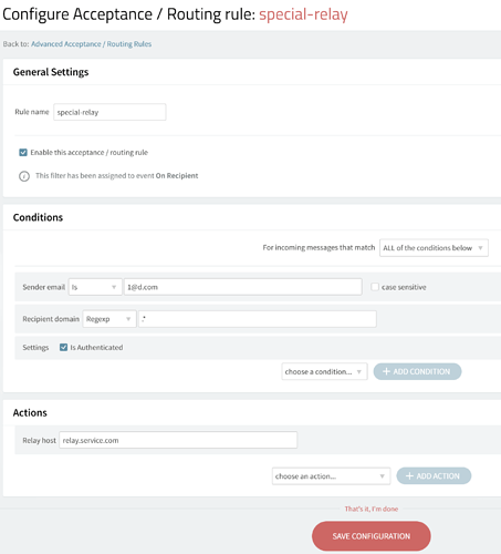

Hello Jay,
Have you tried to addan advance routing rule simiilar with the following one:
I’ve not tested but it should work. Maybe it may need some tweaks but I hope you get the point of what I was trying to do.

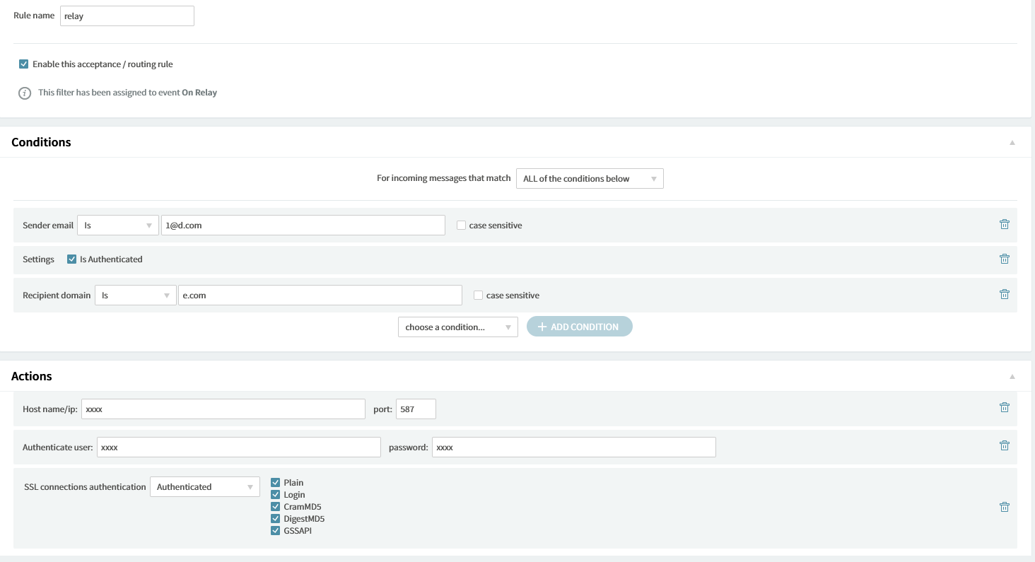

After doing multiple test from advance routing still does not relay externally.
It loops directly on its mailbox / domain and to other hosted domain.

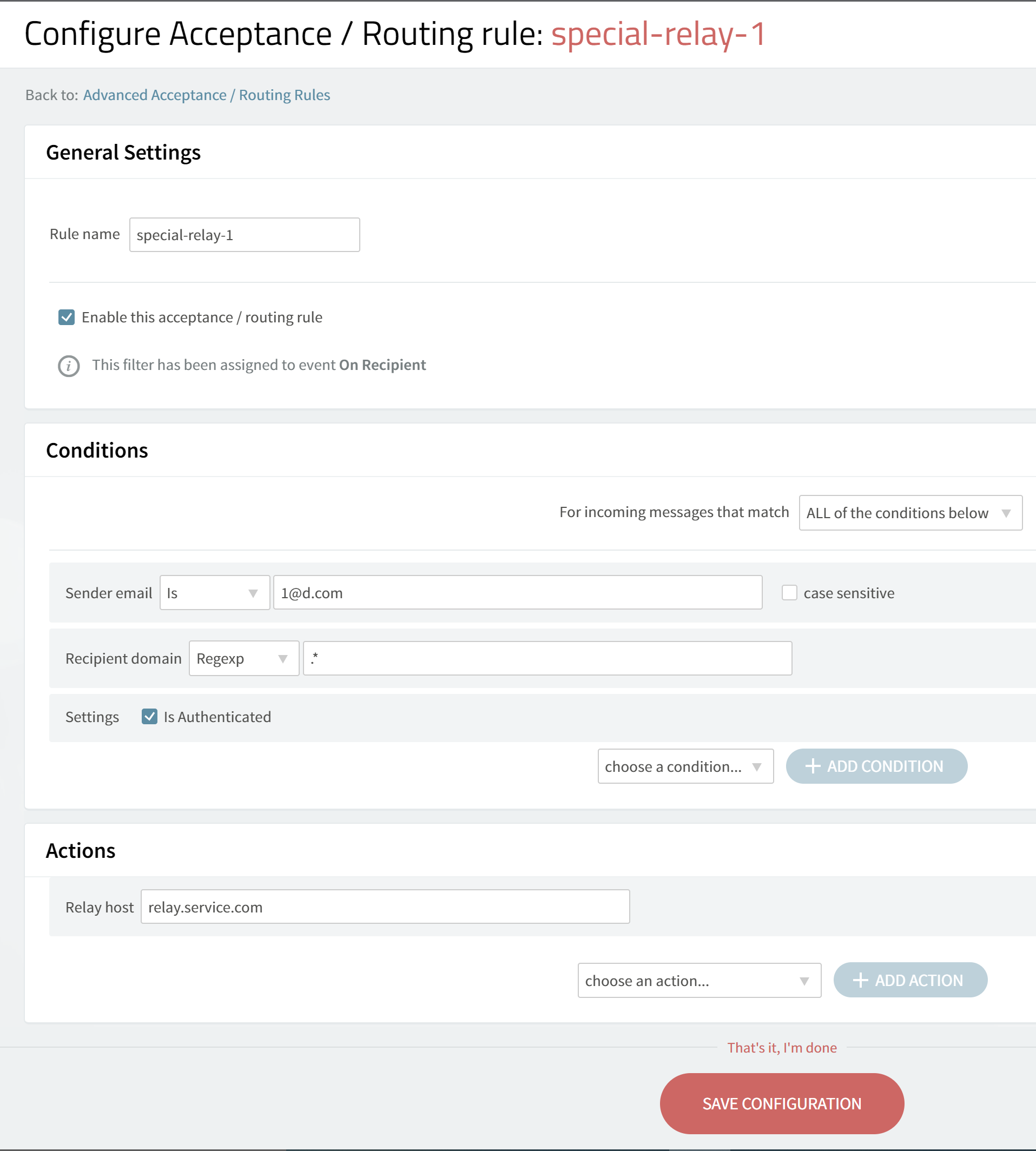

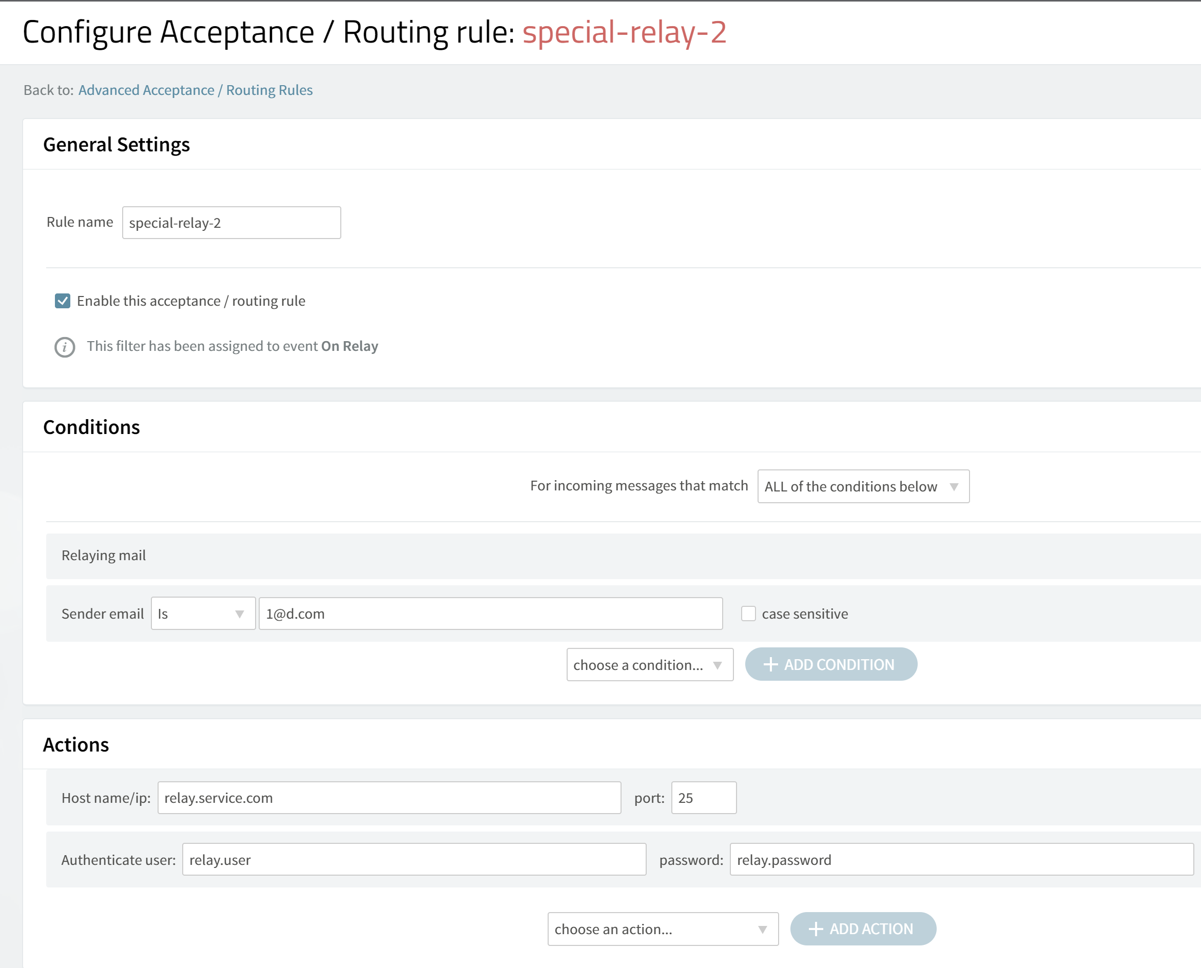

Hello Jay,
So, because you need to send via an authenticated SMTP relay than you have to split the rule in 2 parts:
1/ A rule that will set a relay rule for all messages sent by the special account (in our case 1@d.com)
2/ A rule that set credentials for the special relay session set for that account
From my simple tests all looks fine but in your particular setup it may not work without any further tweaks.

Thanks a lot. The concept works. Appreciate always.
Modified the way I wanted to use it and working as it should be.
