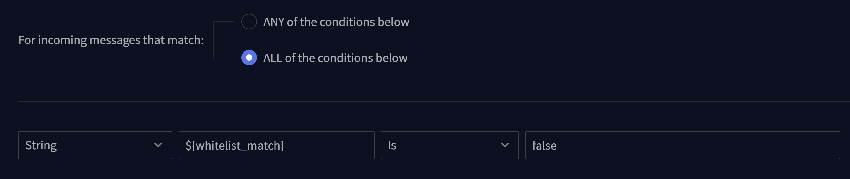

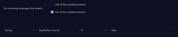

From our understanding only the whitelist capability may be influenced if you made your own spam filter based on the header added by spamassassin-bin filter (but only if you do not take into consideration the whitelist_match variable like below)
