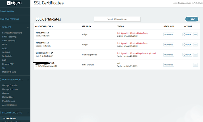

In Axigen, under SSL Certificates, i upload these 4 files and the show up as Valid.

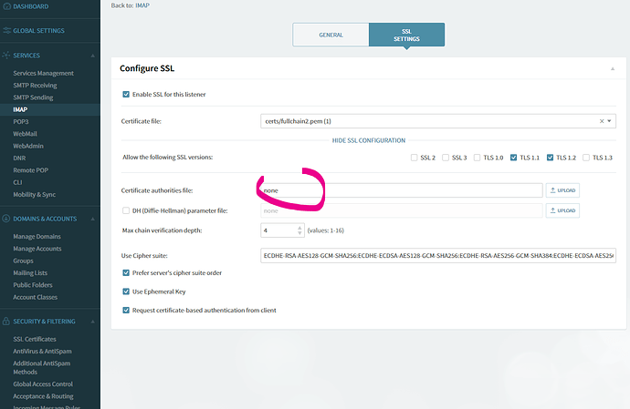

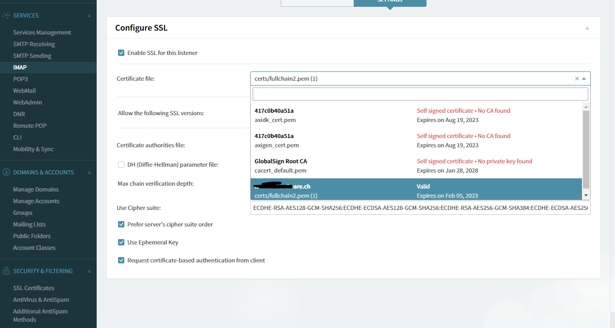

After that i go to IMAP and edit the listener, i switch to SSL Settings and choose my before uploaded Certificate file, it shows as valid.

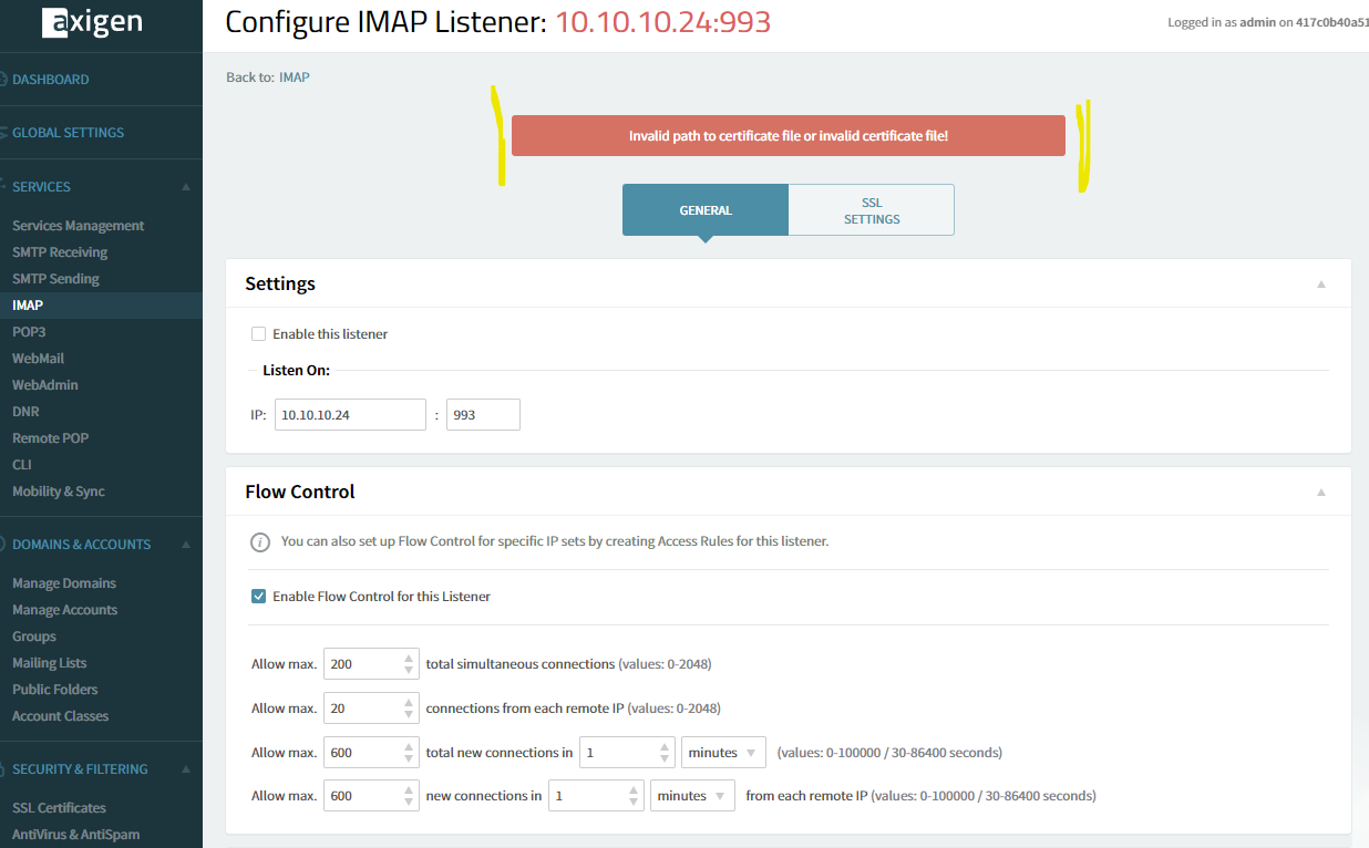

And there I’m stuck, i always get: Invalid path to certificate file or invalid certificate file!

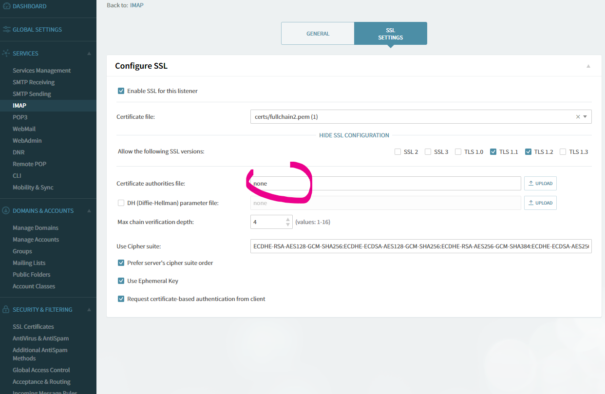

Which file or path do I have to enter in “Certificate authorities file:”
Thanks for the help! Im searching the web for hours an find no solution.

under SSL-Certificates it looks like this (picture 1)
Im going into IMAP, then go to SSL-Settings and choose the SSL-Certificate (picrute 2 & 3)

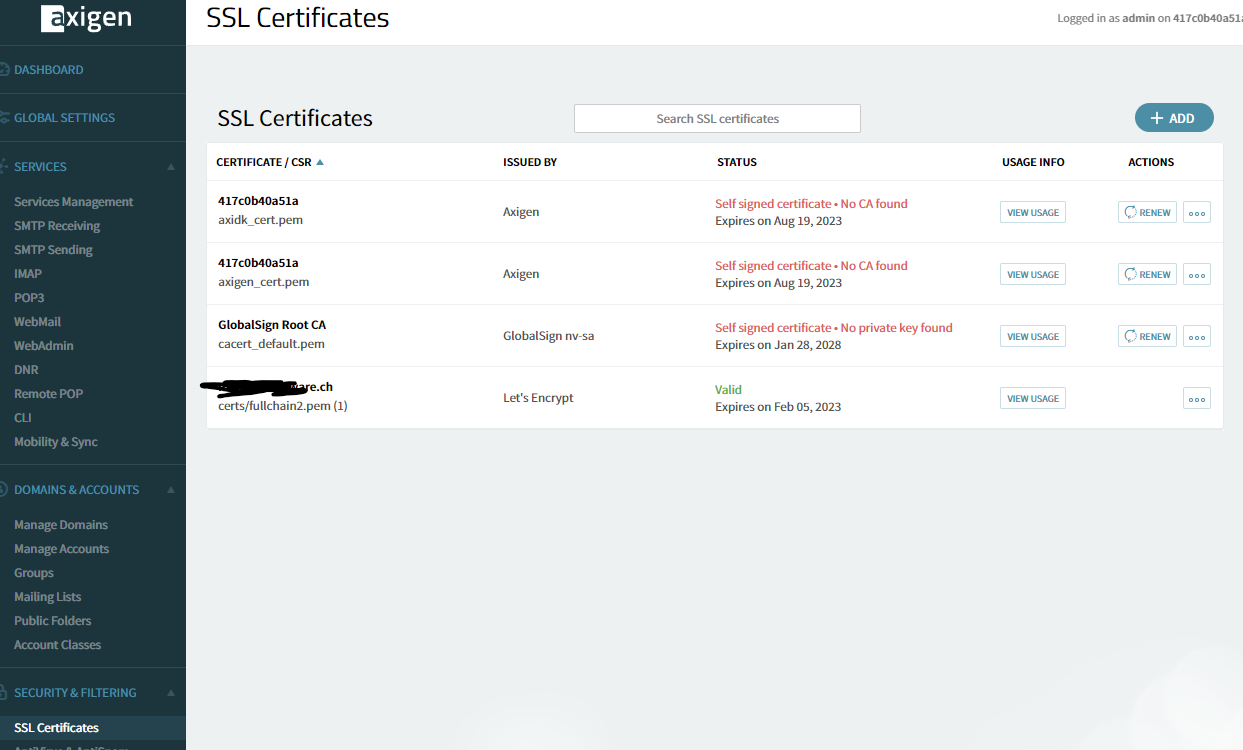

It looksl like this, no matter what i do with the certificate authorities file: it always gets an error (picture 4)
hope you can identify my mistake

Because you have uploaded all cert specific files you could leave the Certificate authorities file set to ‘none’ (or empty).
Yes, i tried that. Still get the same Error as i try to Enable this listener pic 4

Could you please remove the certificate you have created under SSL Certificate and create a new one but only containing cert2.pem and privkey2.pem files?
If it confirms as valid in that section, what is happening if you try to set into the IMAP listener?

Hi there, the last advice surely will work. I am using the same with Letsencrypt. Just create a new file with the cert and priv file.
This is on this thread as well.
