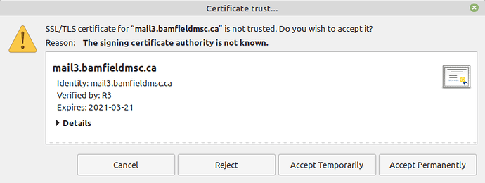

Have a test install of Axigen. I was able to generate and use Let’s Encrypt cert, but email clients will reject the certificate or not even connect. When I run a third party scan against the FQDN of the server I get failure due to untrusted certificate issuer. I ran the scan against ports 81 AND 993

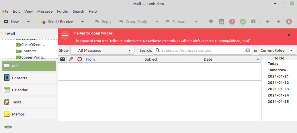

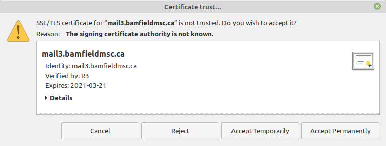

Evolution email client on Linux throws 2 errors shown in images, need to manually accept certificate (untrusted issuer) and then when account configured, cannot access folder
