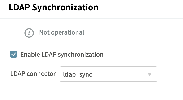

Also, in the webadmin > Domains & Accounst > Manage Domains > Domain redacted:
See attached image.
Well, the Not operational part was “solved” by an disable/enable/save action but the sync would still not add IDs for users and new users are not being saved to Axigen.
