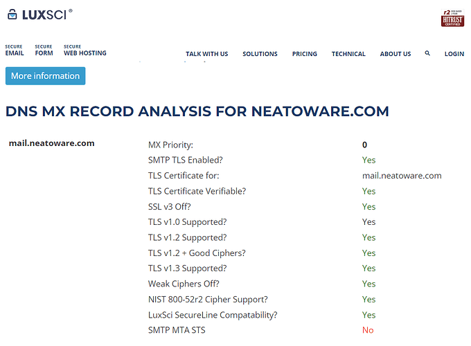

Unable to perform STARTTLS
Sending email to some domains I get a failure message from Axigen saying ‘Unable to perform STARTTLS’
I have searched high and low for a solution, and have followed various Axigen KB articles best I can, but the issue remains.
Testing my domain using ‘SMTP TLS Checker For Inbound Email Servers | LuxSci’ reports all ‘Yes’ except for ‘Certificate Verifiable? = No’
Axigen log files report …
SSL_connect error: error:0A000086:SSL routines::certificate verify failed
I’m using a LetsEncrypt certificate generated from with Axigen. The certificate is valid (i.e. not expired). Looking at ‘View Usage’ for the certificate it is assigned to all services.
OS is RHEL v9.3. Axigen is v10.5.15
So it seems my certificate cannot be verified but I’m at a loss as to where to look and how to fix the issue.

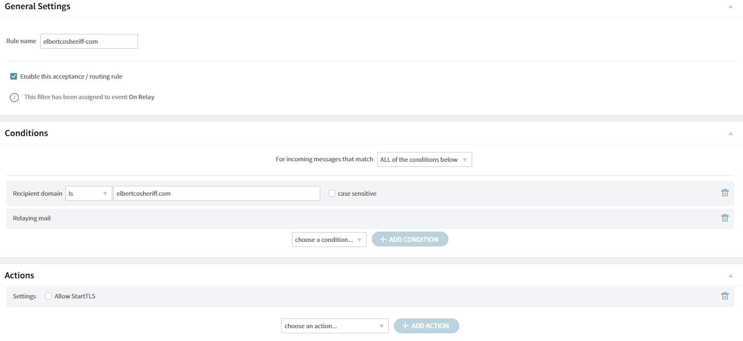

I’m experiencing the same behavior. For me, it’s occurring when there are problems with the receivers’ TLS configuration. Some examples currently in my logs are domains with expired SSL certs (an SMTP-OUT attempt to oglethorpefirerescue.org appears below).
Any ideas for a custom acceptance & routing advanced rule that would send without STARTTLS when a handshake wouldn’t allow for performing STARTTLS? One that wouldn’t require me to conditionally define every misconfigured domain (see the attached screenshot)?

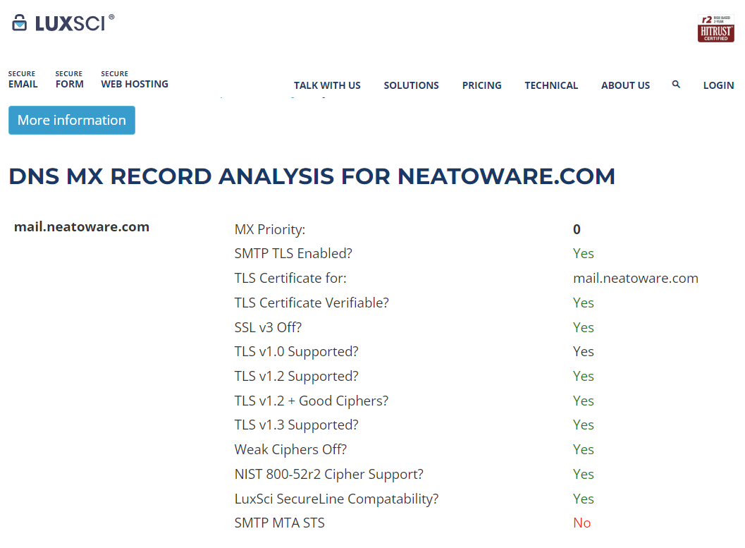

A very useful online tool to see exactly which certificate(s) is/are received from your server’s listener is:
Ioan,
We’re seeing TLS Certificate Verifiable errors when we set Certificate authorities file with letsencrypt/[domain]/cert_auth.pem because it’s not a fullchain.pem. To pass some SMTP servers’ tests, Axigen needs to supply Let’s Encrypt’s R3 and ISRG Root X1 certs in a fullchain.pem.
Test an Axigen server with SMTP TLS Checker For Inbound Email Servers | LuxSci or //email/testTo: and you should see the types of certificate errors some SMTP servers throw.
Then test using the fullchain.pem I’ve pasted below.

Hi @ethanol,
I’m finding the same as you. The Axigen built-in LE certificate management doesn’t seem to work and I too need to provide a fullchain.pem externally.
I also used the LuxSci SMTP TLS checker site and is how I discovered my TLS Certificate was not verifiable. After manually creating and installing the fullchain.pem the TLS cert now verifies OK …
MX Priority: 0
SMTP TLS Enabled? Yes
TLS Certificate for: [mail.mydomain]
TLS Certificate Verifiable? Yes
SSL v3 Off? Yes
TLS v1.0 Supported? No
TLS v1.2 Supported? Yes
TLS v1.2 + Good Ciphers? No
TLS v1.3 Supported? Yes
Weak Ciphers Off? Yes
NIST 800-52r2 Cipher Support? Yes
LuxSci SecureLine Compatability? No
SMTP MTA STS No
The “TLS v1.2+Good Ciphers = No” section has led me down the NIST path (referenced in the LuxSci test page) looking for an alternate set of ciphers for Axigen. It’s not a red-hot issue so for now I’m just tinkering with this bit.
I also used the //email/testTo: (checktls.com) site for debugging this issue. Prior to my manual intervention with installing the LE cert the test returned errors. After manually installing my fullchain.pem the test returns:
CheckTLS ConfidenceFactor for “[mydomain]”: 114 of 114 (100%, 121 max)
… which is kind of nice.
Although I now have a working system (at least for the next 90-days :slight_smile: ), I’ll have another play with Axigen’s automated LE solution, taking @indreias comments & suggestions on board.
There is another “fly in the ointment” I haven’t mentioned (and maybe I should have), my RedHat server runs Axigen (obviously) and also Apache for various websites. Ports 80 and 443 are normally used by Apache. When I needed to let Axigen automatically run the LE cert renewal (during this debugging exercise) I stopped my Apache server and let Axigen have ports 80 and 443. This worked fine during the debugging.
My ultimate solution here would be to let Certbot look after all the LE certs, as it already does for my websites. Then simply point Axigen to /etc/letsencrypt/live/[mail.mydomain] directory and the .pem soft links located there.
Hello @AdrianW ,
Mozilla has a TLS reference guide, Security/Server Side TLS - MozillaWiki, that I used to put together my cipher set:
TLS_CHACHA20_POLY1305_SHA256:TLS_AES_256_GCM_SHA384:TLS_AES_128_GCM_SHA256:ECDHE-RSA-CHACHA20-POLY1305:ECDHE-ECDSA-CHACHA20-POLY1305:ECDHE-RSA-AES256-GCM-SHA384:ECDHE-ECDSA-AES256-GCM-SHA384:ECDHE-RSA-AES128-GCM-SHA256:ECDHE-ECDSA-AES128-GCM-SHA256:DHE-RSA-CHACHA20-POLY1305:DHE-RSA-AES256-GCM-SHA384:DHE-RSA-AES128-GCM-SHA256:ECDHE-RSA-AES256-SHA384:ECDHE-ECDSA-AES256-SHA384:ECDHE-RSA-AES128-SHA256:ECDHE-ECDSA-AES128-SHA256:DHE-RSA-AES256-SHA256:DHE-RSA-AES128-SHA256:AES256-GCM-SHA384:AES128-GCM-SHA256:AES256-SHA256:AES128-SHA256:AES256-SHA:AES128-SHA:DES-CBC3-SHA:HIGH
These ciphers seem be working well, but I’m no cipher expert. I’ve enabled TLS 1.0, 1.1, 1.2. 1.3 with the rationale that some 1.0 or 1.1 encryption is better than no encryption.
I’m using axigen_dh.pem for my DH parameter file.

Hi @ethanol,
So in the end I’ve settled for this:
TLS_AES_128_GCM_SHA256:TLS_AES_256_GCM_SHA384:TLS_CHACHA20_POLY1305_SHA256:ECDHE-ECDSA-AES128-GCM-SHA256:ECDHE-RSA-AES128-GCM-SHA256:ECDHE-ECDSA-AES256-GCM-SHA384:ECDHE-RSA-AES256-GCM-SHA384:ECDHE-ECDSA-CHACHA20-POLY1305:ECDHE-RSA-CHACHA20-POLY1305:DHE-RSA-AES128-GCM-SHA256:DHE-RSA-AES256-GCM-SHA384:DHE-RSA-CHACHA20-POLY1305
Which returns this on the LuxSci TLS Checker:
MX Priority: 0
TLS Certificate for: mydomain
SSL v3 Off? Yes
SMTP MTA STS No
I still can’t figure out what cipher suite(s) to add for “TLS v1.2+Good Ciphers = Yes”, but for now, I don’t think it is a show stopper.
LuxSci SecureLine seems to be a proprietary email encryption thing, so I can live without that I think.
And MTA-STS might be something I need to add in the future, but for now, I’ll leave this on the back-burner.
Going back over @indreias comments and having a re-think, it might be that we can also resolve the Axigen automated LE Cert renewal issue by manually adding the LE CA certificate in the “Certificate authorities file:” section in WebAdmin > Services > SMTP Receiving > Listener(s) > Edit > SSL Settings > Show SSL Configuration > Certificate authorities file: and upload/point to the LE CA .PEM file (in my case /etc/letsencrypt/live/[mydomain]/fullchain.pem - see note below). Of course, we would need to do the same for all the other listeners and services.
Might be worth the experiment.
Note: this is a soft link so not sure exactly how this will work out.
@AdrianW ,
Using the ciphers I posted above, I was able to get the following luxsci result.
