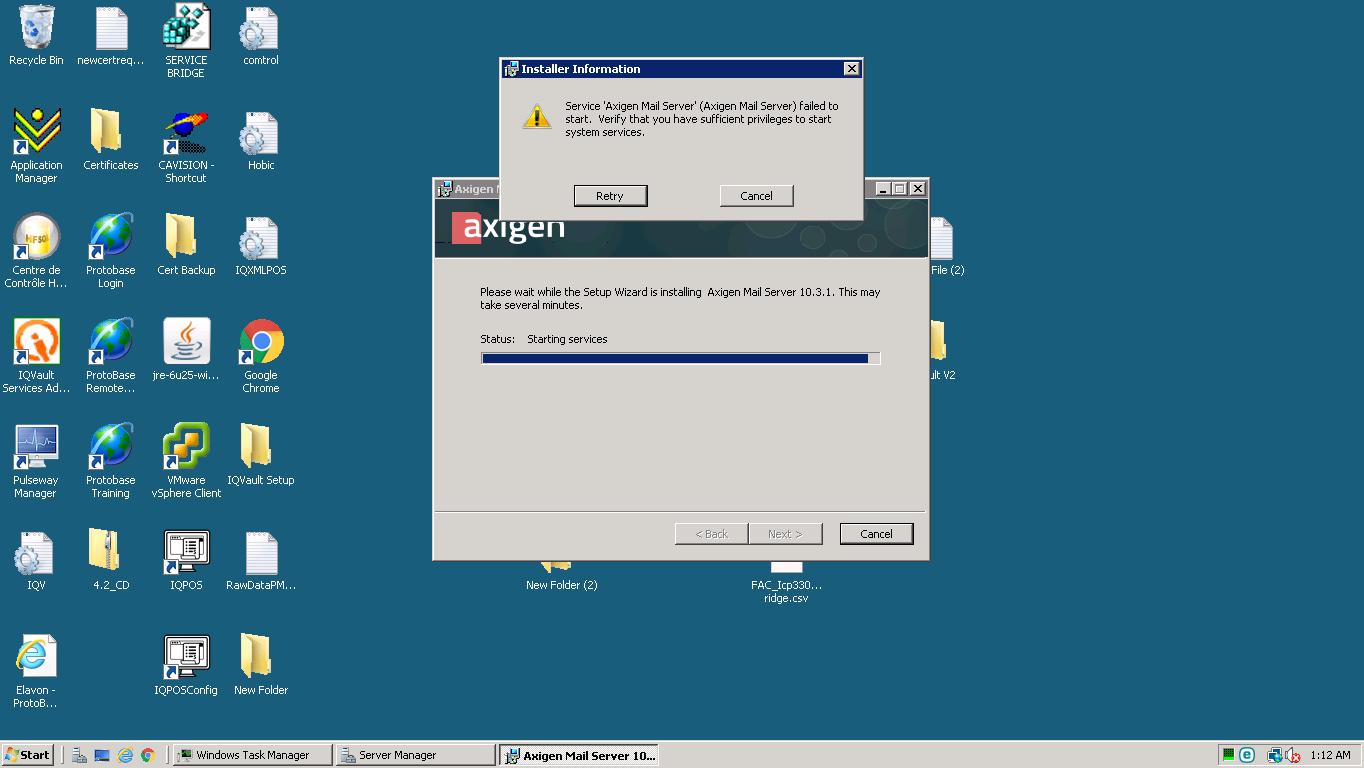

I have been using Axigen for quite a while and I have done in place upgrades for ever since. With the new version they have brought out I am getting an error where the service will not start. If i click cancel the installation stops and roll backs. Has anyone had this same issue?

Have you tried to run the installer with the main “administrator” user?
We have found that in some installations the account used for upgrading Axigen has not enough rights for installing system services.
I am using the network administrator and another thing the file does not have the option to right click on it and say run as administrator
I tried the local administrator account still same error

Hi, I just tried to upgrade as well to the latest version on Windows server 2016 and I had the same problem as you mentioned in the picture. I tried everything, even fresh installation and nothing, still the same error. I tried it as domain admin or local admin and nothing. Then I tried to install on different “clean” server and it worked.
I had similar problem with the older version.
So maybe this can help you, as I use ClamAV and Spamassassin as service, I stopped all these 3 services and then everything worked as it should and upgrade was successful. So maybe try to stop these services, if you have them.
