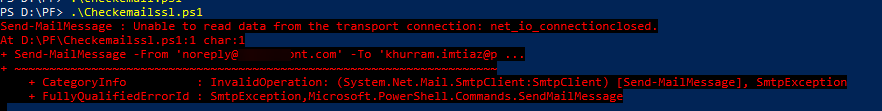

I am using this script for sending email via powershell.
Send-MailMessage -From ‘noreply@xyz.com’ -To ‘khurram.imtiaz@xyz.com’ -Subject ‘Sending a test’ -Body “This is just a test” -SmtpServer ‘mailr14.xyz.com’ -UseSsl -Port 465
Getting this error,
If m doing telnet it showing blank black screen so it looks like its connecting to server but something is missing.
Send-MailMessage : Unable to read data from the transport connection: net_io_connectionclosed.
At D:\PF\Checkemailssl.ps1:1 char:1
  • Send-MailMessage -From ‘noreply@xyz.com’ -To 'khurram.imtiaz@x …
  •   + CategoryInfo          : InvalidOperation: (System.Net.Mail.SmtpClient:SmtpClient) [Send-MailMessage], SmtpExcep
     tion
      + FullyQualifiedErrorId : SmtpException,Microsoft.PowerShell.Commands.SendMailMessage

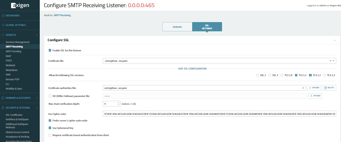

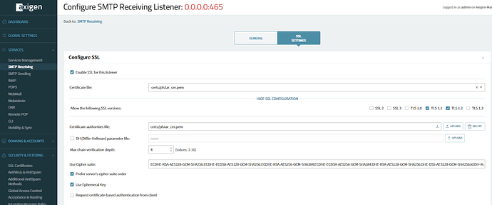

Could you please share the screen capture (from WebAdmin) for SSL configuration on Axigen listener configured for port 465 used by your script?
Here it is,

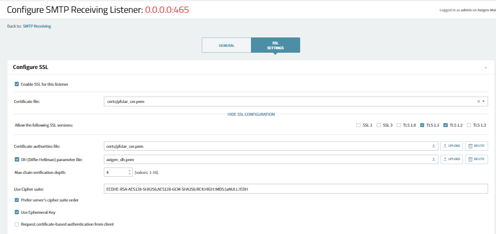

1/ in case the Certificate file contains all needed data there is no need to reffer again into Certificate autorities file
2/ Please tick the DH parameter file and set it to axigen_dh.pem (before this please double check if you have this file into Axigen working dir)
3/ Please set the following Cipher suite: ‘ECDHE-RSA-AES128-SHA256:AES128-GCM-SHA256:RC4:HIGH:!MD5:!aNULL:!EDH’ as maybe there is an incompatibility at this level with the existing configuration

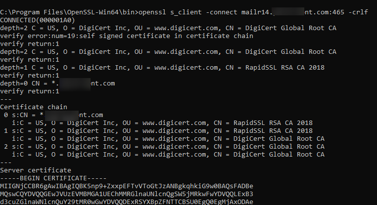

If this still not solve your issue please check if all is fine with openssl (as telnet is not the appropiate tool to debug SSL connections) like:
$ openssl s_client -connect <your-axigen-server_IPaddress>:465 -crlf
Also, a good ideea is to set log level to Protocol Communication for SMTP Receiving service and share the SMTP-IN log lines geenrated by Axigen when you are trying to connect with your script.
I made the mentioned changes,

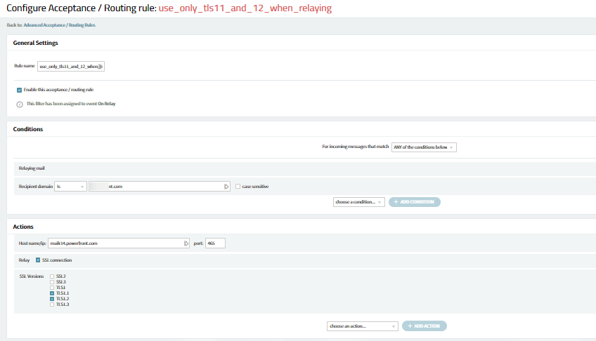

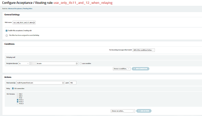

Added a Rule as per the community guideline,
But after adding this rule, i am unable to send email with port 25 aswell, disabling this rule can make it working.

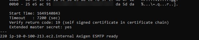

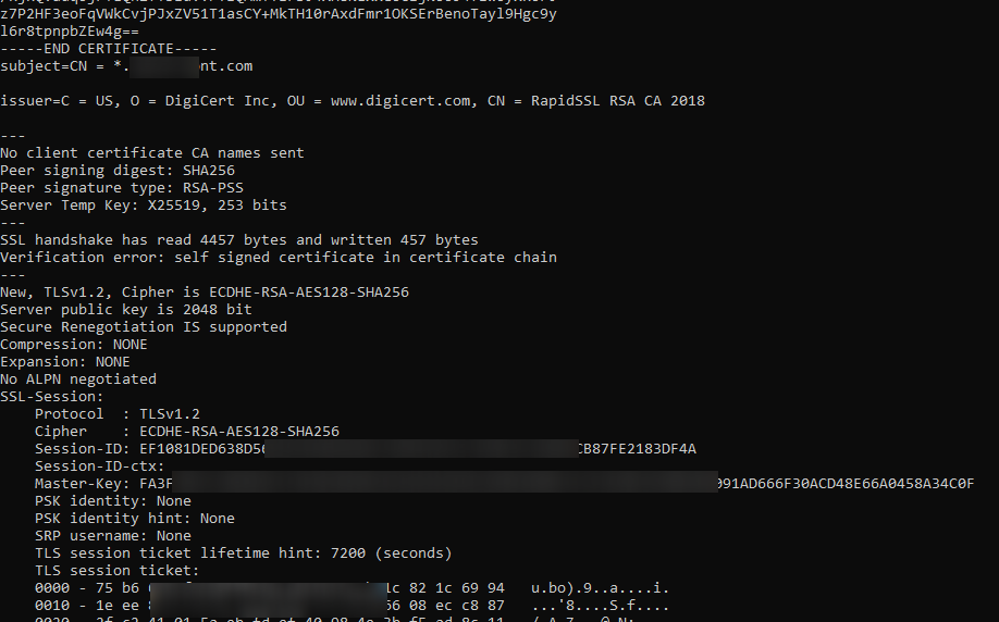

With port 465 i used the openssl command you mentioned, pasting the result.
Using the script mentioned above for port 465

Without SMTP-IN logs we could not point you to any hints. I do not see any error on port 465 when using openssl so should double check if:
1/ you have set SMTP Receiving service on Protocol Communication
2/ you have access to the log file where this service is saving the logs (needs to be in Protocol Communication as well)
After that you could compare the SMTP-IN log lines generated for the test with OpenSSL and the log lines generated by your PowerShell script
