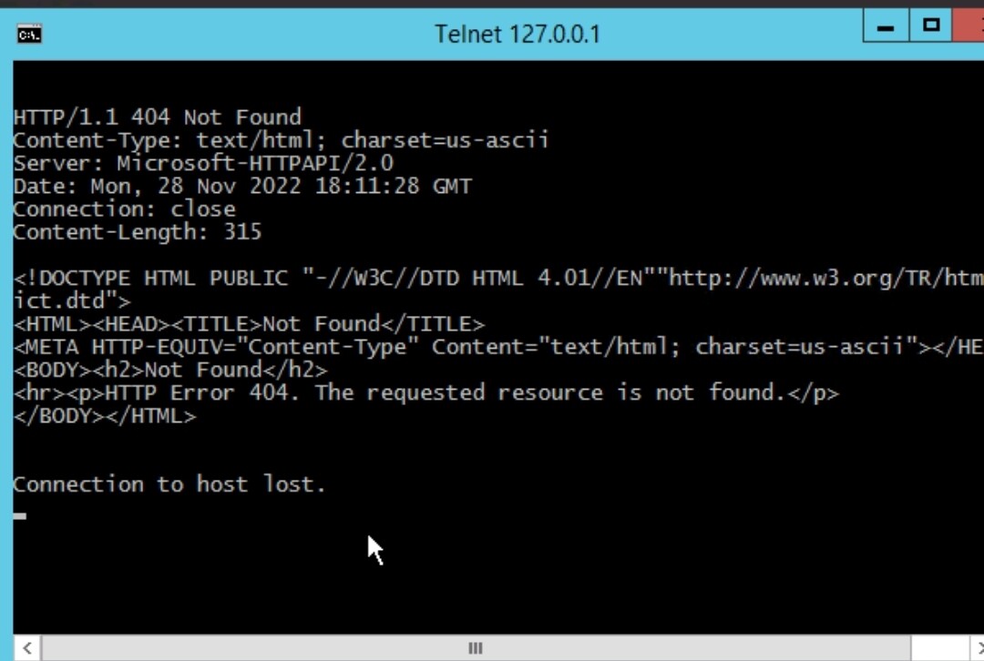

let’s see what you get when simulating an HTTP request via a telnet command executed from the Windows terminal, like:
$ telnet 127.0.0.1 80<press-ENTER>
GET / HTTP/1.0<press-ENTER>
<press-ENTER>
I dont know If this was what i supposed to do
ok - so, as you see, the output was provided by the Microsoft-HTTPAPI server and not Axigen.
Now, if you are sure that the telnet commands were executed on the console from the Windows server where Axigen is running, I could not provide any explanation why you have another server (which is identifying as Microsoft-HTTPAPI) intercepting / responding on the same port as Axigen WebAdmin is supposed to respond so you definitely have to extend the investigations.

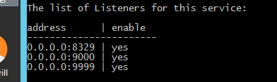

From Axigen side we could add another HTTP listener for WebAdmin service so you could try to connect on that port (for example, via CLI, like: config server > config webadmin > add listener 0.0.0.0:9999 > commit > save config).
Ok, probably because we have some other services that provide interfaces on local 80? Redis, xampp, …
So I’ve done the setup on 9999. Should it respond on localhost:9999 now?

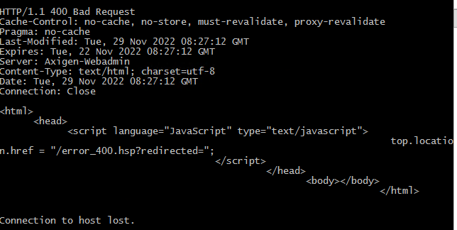

so, could you please:
1/ open a new cmd terminal on the Windows instance that is running Axigen server
2/ execute the following commands:
$ telnet 127.0.0.1 9000<press-ENTER>
<press-ENTER>
And coming back to your last question - could you please re-run the CLI commands mentioned in post #6 so we’ll see if the listener on port 9999 has been added and it is enabled?
If yes, what you get (from a web browser and telnet) when connection to it locally?
this is for 9000
and for 9999 (added a 8329) for good measure also
ok - so the Axigen-WebAdmin is providing an answer when connecting to 127.0.0.1 on port 9000. Nevertheless the strange part is that you get a 400 Bad Request error code but at least we are receiving something.
