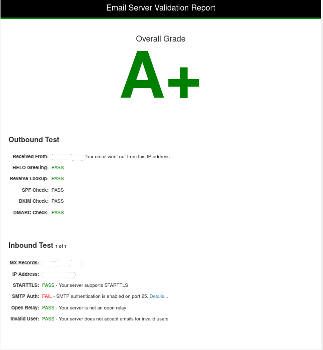

Now validate my server I have only one fault. Login on SMTP port enabled.

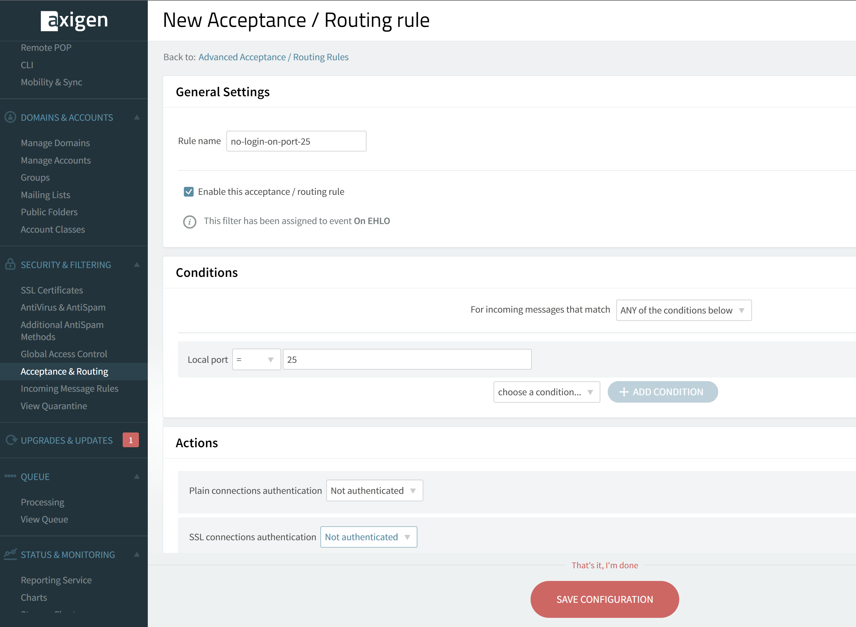

Please try to add an Acceptance / Routing rule (via WebAdmin > Security & Filtering > Acceptance & Routing > Advance Settings) that looks like below:

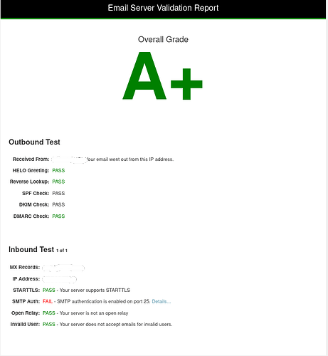

Thank you for your reply. I add your new Acceptance Rule but the SMTP auth enabled on port 25. See the validation message from https://xeams.com/validation.htm

I think your rule blocking auth on port 25.

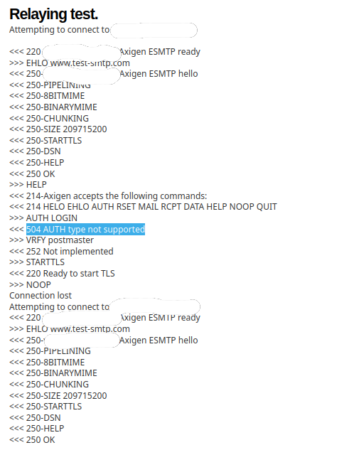

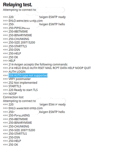

But axigen’s response is an SMTP return code of 214 - the accepted commands include AUTH, so the result of the automatic authentication check is enabled on port 25. And actually the response to the incoming AUTH LOGIN as 504 AUTH type is not supported.

Recommended rule disabled AUTH on port 25 with or without StartTLS.
From your last message it is very clear that you get a 504 response when trying to use authentication (despite that it was not mentioned into the 250 banner sent after your EHLO command).
Presence of AUTH into the output of HELP command is totally harmless.
The answer on why the inboud test validator from Xeams is saying that authentication is enabled on port 25 could be provided only by them so my suggestion is to have a clarification session with them.
Note: It will be a good idea to have at hand your server logs from SMTP Incoming service, preferable set on Communication Protocol (check log lines containing SMTP-IN from the default log location /var/opt/axigen/log/{default,everything}.txt
