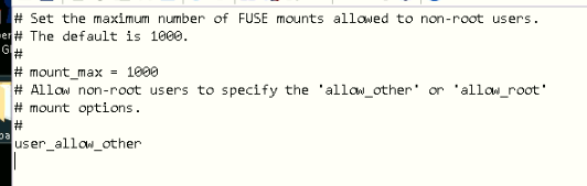

did you uncomment " user_allow_other" in file ‘/etc/fuse.conf’ ?
Important! After ‘user_allow_other’ you must have an empty line
@Mohammad
Yes, all was done properly.

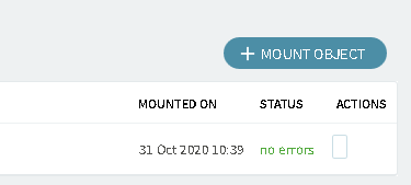

Hello Jay,
Are you running the command from the server or from a remote PC (for example via a SSH session)?
I’m asking this because the exposed mount point (that you could successfully mount via WebAdmin - as mentioned in post #3), for obvious reasons, could be access only on the server.

Hello Jay,
Could you mount and unmount /mnt/axigen from WebAdmin (as you have already test in post #3
If the mount is successful, what is the output from:
ls -rtl /mnt/axigen/*
Could you please increase log level for CLI service to Protocol Communication, try again to use the backup script and post here the relevant CLI logs?
@indreias
Mounting from WebAdmin Good.
